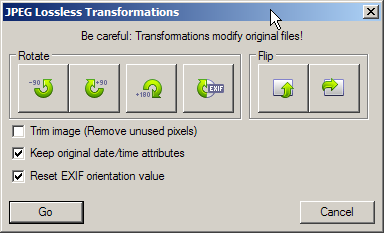

may i ask a question ?
but this feature in the screeshot is Lossless ?
drugo
- Posts: 120
- Joined: Wed Jun 02, 2010 6:23 am
Re: Lossless rotate question
but the author of the program saidJohnFredC wrote:Hi drugo...
Lossless rotation applies only to jpgs and other formats that use a "lossy" compression algorithm.
do i miss something?No it's a different choice. You have lossless rotation (which change picture data), and EXIF orientation field
thanks

No change in XnView v2.32 (2015-03-16).
The options are displayed under Browser > Misc. > Rotation as follows:
They refer to the saving of rotated JPEG images. So they would better fit under General > Read/Write > JPEG > Rotation as follows (default):
These options should also be shown in the JPEG Lossless Transformations dialog window (directly or after clicking an "Options" button). See the following picture:
There should be an additional option:
[ ] Save current settings as defaults
Perhaps there could also be a preview window to see how the image will look after the transformation.

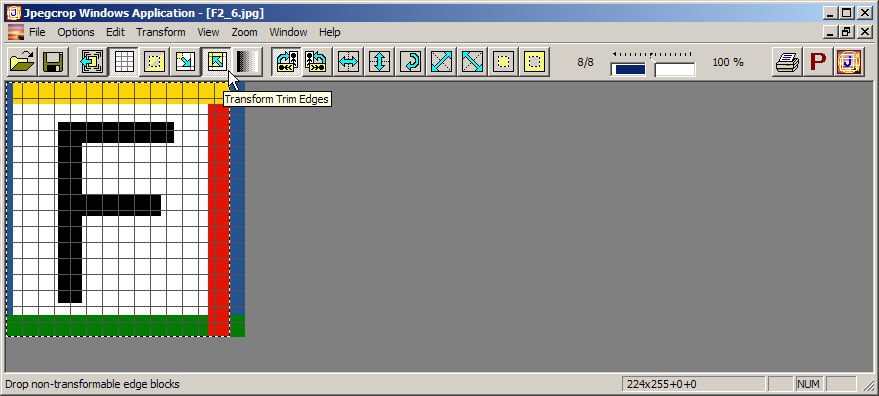

Here is a demo program for lossless JPEG rotate and crop: http://sylvana.net/jpegcrop/

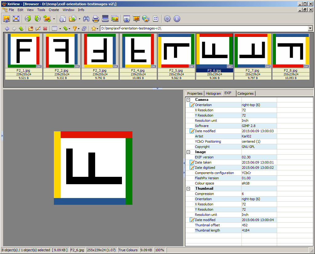

I've created a new set of testimages for testing the lossless JPEG rotation.
Preview:
Specifications:
- colored borders with a width of 22 pixels
- JPEG block size is 16 pixels for chrominance (color subsampling 4:2:0)
- width and height are different and not a multiple of the JPEG block size (239 x 255 for normal orientation)
- JPEG optimized and progressive
- embedded thumbnails
- 4 different EXIF dates with different seconds:
-- 01) 0x9003 DateTimeOriginal
-- 02) 0x9004 DateTimeDigitized (CreateDate in ExifTool)
-- 03) 0x0132 ModifyDate for main image
-- 04) 0x0132 ModifyDate for thumbnail image
Download: Test in jpegcrop:
Preview:
Specifications:
-- Karl
