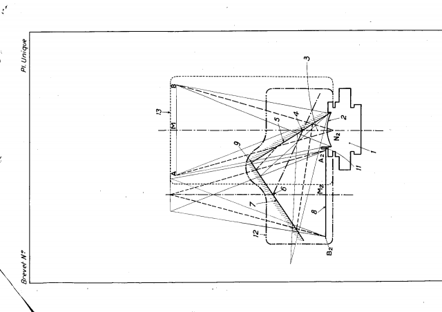

Recently, I scanned many old industrial design images (patent descriptions, schematics, etc...) from old paper, and tried to make them "brand new" by modifying them in XnView, using contrast/light/gamma to get very good black and white schematics, and record them as 2 colors/one bit png files.
I tried to print one of them, and the print was fully black, with white lines. This is very expensive, in ink or toner, and not what is expected.
To verify if it is really a bug, I started from the same original image, enhanced it, but recorded it as a 24 bits jpg file. The file was far bigger than the 1bit png, but the print was OK : black lines on white background.

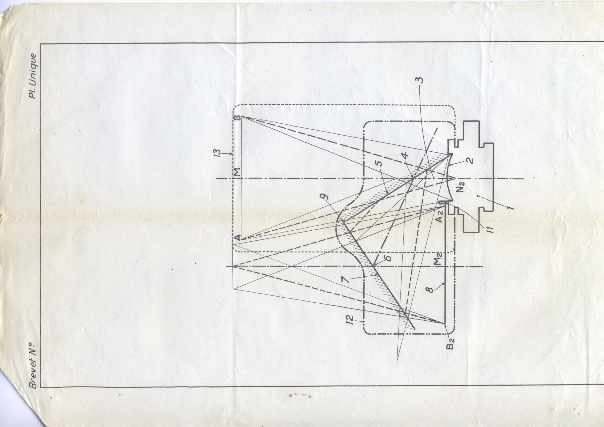

The .png file was obtained using XnView "classic" (yes, for some jobs, I prefer the look and feel of XnView "classic"), using wine / Ubuntu .
scan (simplescan) on a MF printer, giving a "full color" png file, 446Ko Then edited for contrast/light/gamma to get good black and good white, and then "converted to binary, no framing" using the menu "color" of XnView 1.98.5 and saved as png file (compression level 6, it is the default value, but it does not seem to be destructive), so as to get a very small file (around 20ko). and then I converted it to jpg full color : the print is ok I don't think the problem could come from the printer in bitmap mode, but I can find some other printer (test made on a wifi Brother laser printer), If needed, I can turn back on my damned/disliked Canon MG6150.

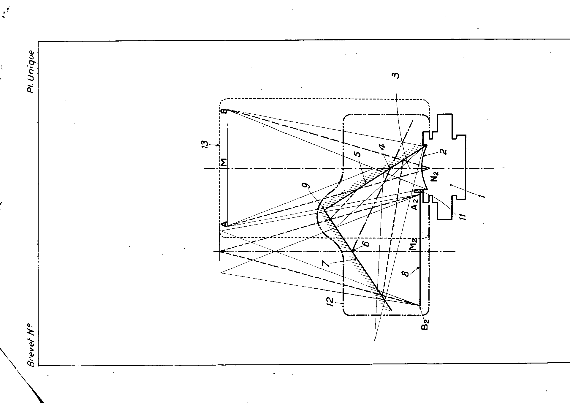

I just tested your attached file, Test 1-bit PNG_ZIP.zip:
when I print the png file, it is output as white text on black background (the display on screen is black text on white background).
The one-bit tif file behaves exactly the same : prints as white text on black background (on my two printers).
