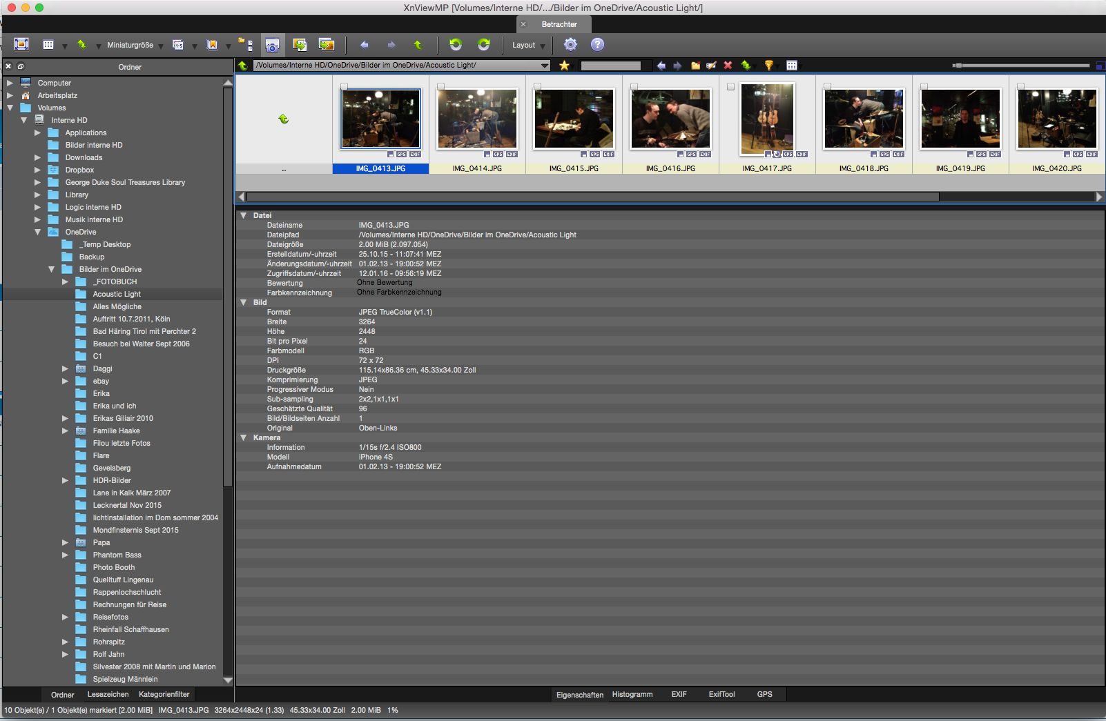

got a weird layout here, the preferences, histogram, etc. takes 2/3rd of the space on the right side (see pic attached). I cannot change the size of it. I know I clicked some registers away before but unfortunately I don´t find a chance to roll it back to the status when I launched the program first time. Any idea? Thanks for your help.

notebynote wrote:Hi,
You might try locating the .ini file using Tools > Settings > Integration > Paths, then delete it and relaunch XnView MP...
If that doesn't reset the layout, I'm afraid I can't help.

Unfortunately no, doesn´t help.

My 2 cent:
1.) Try Restoring layouts 1,2,3 ect
2.) Try to Toggle "Vertical Tabs" under: View >> Data pane
3.) Try to grab, then drag and drop the tree or a data tab. Try pulling it from the whole GUI. You have to pull in the blank area next to the x
4.) If you have messed with the QtStyle sheets, Replace them with default Ones from the zip version.
5.) Looks like linux, So i don't know.

Solved, thanks, you have to choose "Free" under View->Layout.
