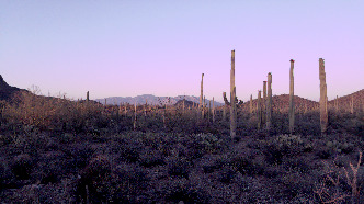

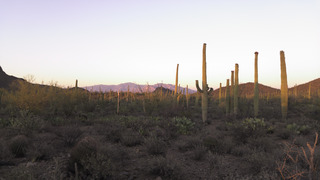

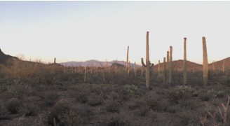

Objective: Trying to produce thumbnails from .dng files that relect the true .dng
I've tried;
1. Settings changed per your suggestion in XnViewMP;
2. XnViewMP 'Before' rebuild thumbnails: Example 1
3. XnViewMP 'After' rebuild thumbnails: Example 2
4. Program 'RawTherapee' default profile, reduce image to 320 pixels wide, save: Example 3

XnView is displaying an almost correct thumbnail now, but when clicked on, it displays the embedded 'incorrect'
.dng thumbnail (Example 1) in Preview, or extract/rebuild one to save ?
Is it possible to regenerate the thumbnail inside the DNG ?

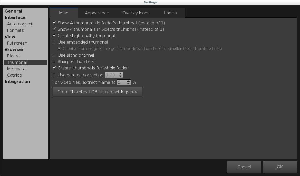

Please take a look at these settings (if you haven't already done so):Katamara wrote:XnView is displaying an almost correct thumbnail now, but when clicked on, it displays the embedded 'incorrect' .dng thumbnail (Example 1) in Preview, or extract/rebuild one to save ?
- Viewer » File » Format settings... » Read » Camera RAW
- Viewer/Browser » Tools » Settings... » General » ICC
As far as I know, EXIF thumbnail - Rebuild (Browser » Tools » Metadata) only works for JPEGs.Katamara wrote:Is it possible to regenerate the thumbnail inside the DNG ?

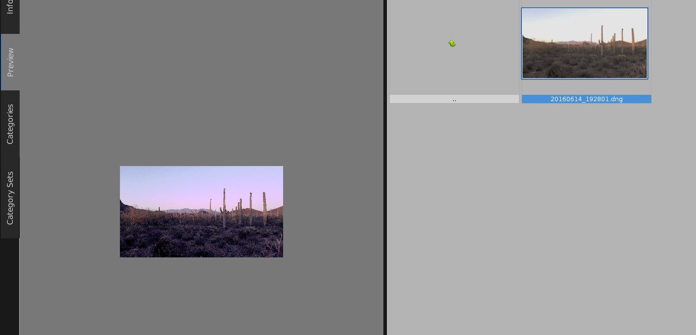

Are your settings from XnView or XnViewMP ?
I couldn't follow exactly with XnViewMP 0.79.
I'm using the below settings (MismatchedThumbs.02.png)
They are producing the correct rendering of the .dng image.
The problem is, the correctly rendered thumbnail (on right) is not what is
displayed on the left preview (MismatchedThumbs.jpg)

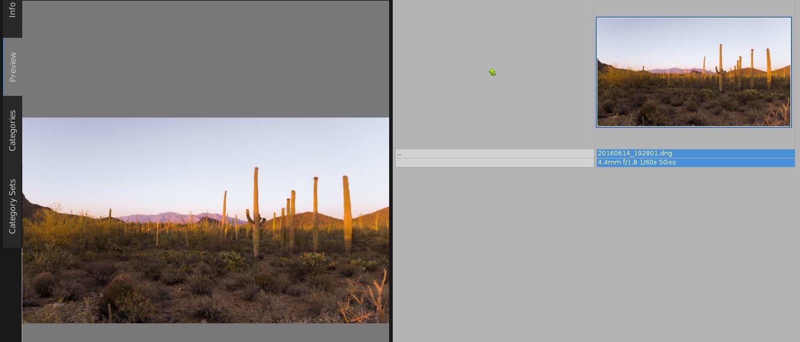

For others frustrated by Smartphone's .dng/.jpg thumbail managing shortfalls...,
Adobe makes available a free DNG converter.
If you are comfortable with using this utility to 're save' your original .dng files that
have already been saved as .dng from the Smartphone...
Select the entire folder of original .dng images, save them to a new folder,
with the 'save preview' (medium or full sized) option checked.
I haven't fully investigated, but my thoughts are, if Adobe (creator of .dng) re saves a .dng
from an untouched original .dng... it should produce an identical copy exept
for the jpeg preview inside the .dng
Then... XnViewMP can accurately display the .dng thumbnail, and large preview image inside the .dng.
Below... the thumbnail on the Right, and the Preview image on the left inside the .dng are now correctly
displayed in XnViewMP.
Best of luck.
