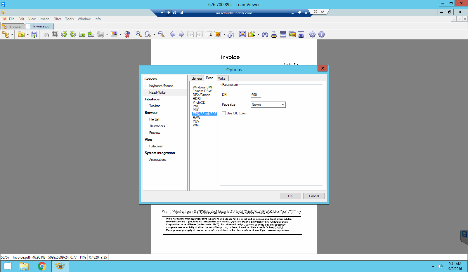

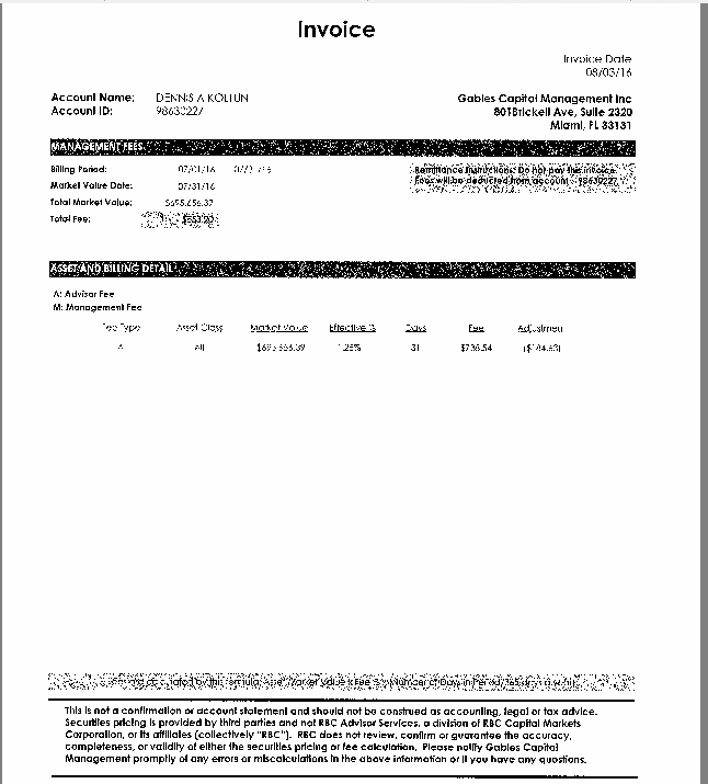

When opening pdfs on XnView, the document is not readable. The resolution is very bad as per the screenshot attached. I already adjusted the DPI settings as per the article here: http://newsgroup.xnview.com/viewtopic.php?f=82&t=31990 but the issue was only partially solved. After zooming the file it can be seen clearly but we have to be able to see it without zooming.
Please advise, thanks.

I would expect 300 to produce a readable image, although the original is a fax which limits the quality to be expected, but if you still have a problem have you tried setting a DPI of 400 or even 600? Can you upload the original file?
Re: PDF Resolution

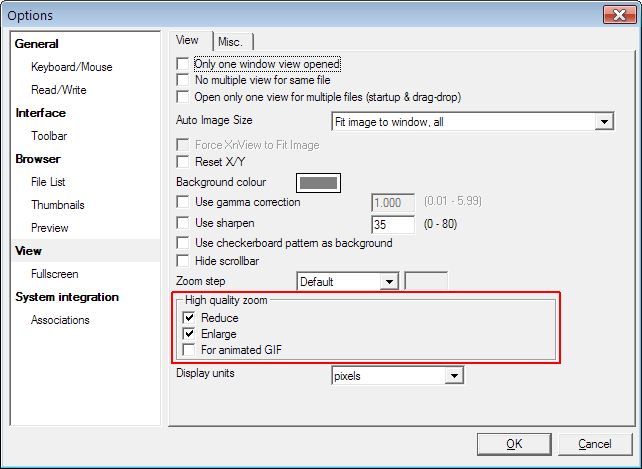

As cday wrote already, your PDF consists of a graphic of a scanned text document (FAX). Already, you've increased the dpi setting (=resolution) which didn't help. Perhaps the zoom quality used by XnView causes the problem. Could you please check your setting in menu "Tools > Options", Category "View", Tab "View", panel "High quality zoom". Here, "Reduce" should be checked.
In addition to the above setting "Reduce" and if your documents contain mainly text, you could try activating "Sharpen" with a low value to make small text better readable. Please note that when activated sharpening will be applied on all images; sharpening should be deactivated before doing detailed image editing/correction.
The above settings will apply when opening the image. For thumbnails there is also a quality setting, you find it in the options Browser > Thumbnails, setting "Use high quality" and "Sharpen thumbnail".

Hi, I adjusted the DPI from Options menu as per the screenshot below. First I put it to 300 and after your reply I also tried to put it to 600 but there was no difference. I attached the original file too.
Please advise. These are scans and they need to be able to read them without having to zoom every time.

2. You do need to have the High quality zoom setting enabled as Helmut suggested:
In Tools > Options :

Putting the High Quality zoom to "Reduce" actually helped to solve this. Thank you both for your help!!
