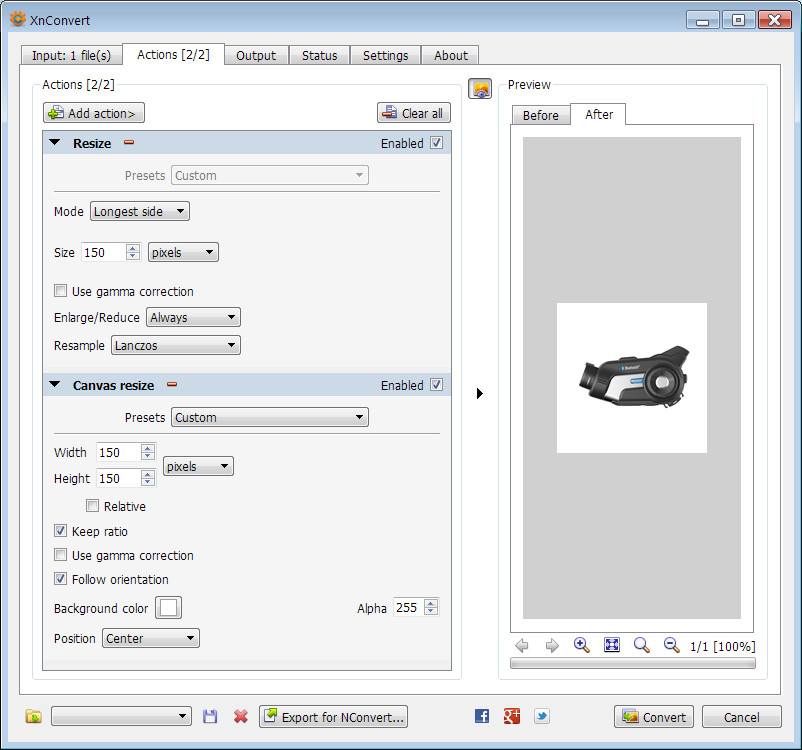

Posts: 4591
Re: resizing all images to the same size without distorting
At a quick look you may need to use a Resize action as well and experiment a bit to get the result you need, assuming that it can be obtained. In my quick test I obtained the following result, not sure if it's exactly what you need or whether the settings shown below are the best:
It may at least give you an idea of how to proceed, and there are plenty of settings to experiment with... :wink:
