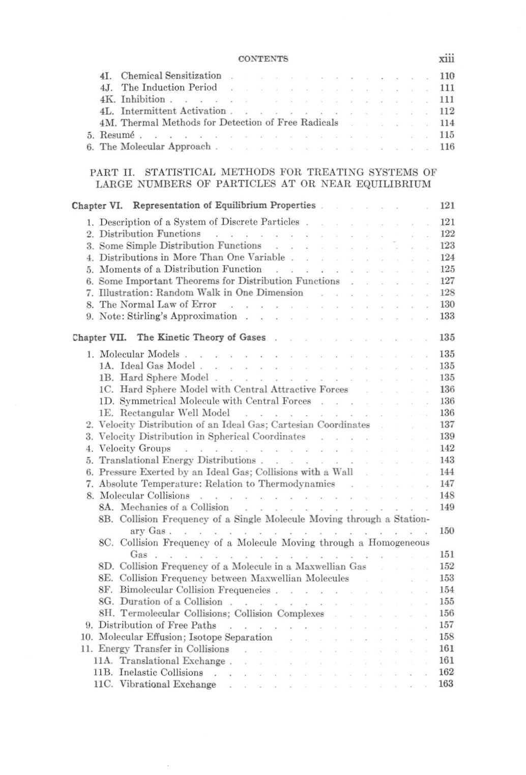

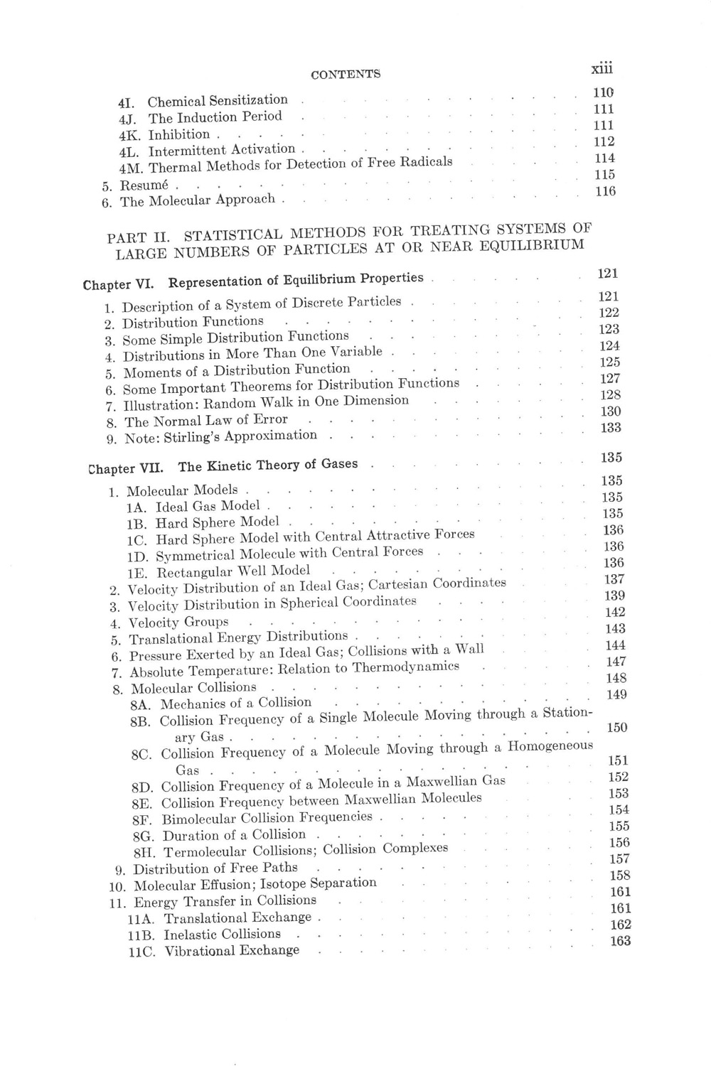

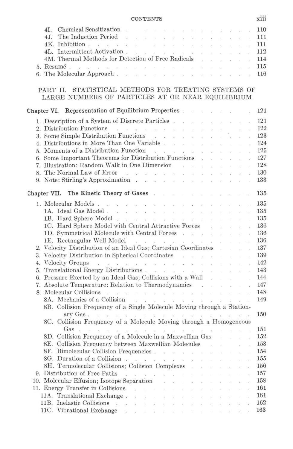

As requested, here is an example. I hope it helps.

NOTE: The above figures are appearing in reverse order. The first one is the final cropped figure. The second one is the auto deskewed figure. The third one is the original figure, as scanned.
