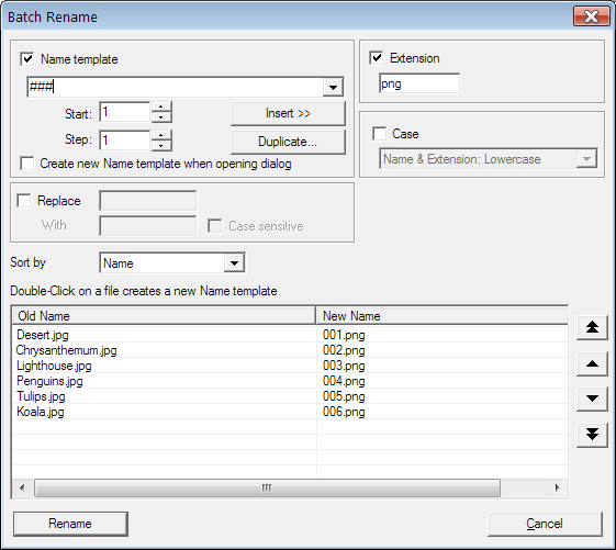

Do you mean to output files with those names from XnConvert as they are created? I don't immediately see a way of doing that at present, although there may be a way, or it might possibly be added later... [Edit: see below for how to do it. :D ]
Or do you simply wish to rename existing files, whether or not created in XnConvert? If so that is possible using XnView Classic, in the file browser Edit > Rename... as below, but note that XnView Classic doesn't support Unicode characters such as foreign accents.
Otherwise, there are many freeware renaming utilities with widely varying interfaces that may require some thought to use, but often provide many powerful renaming methods that are beyond your immediate needs.
Edit:
Setting '###' in the XnConvert Output Filename field does in fact result in output files named as you requested, so files can be created or renumbered that way directly from XnConvert... :D
That naming option doesn't seem to be listed in the Filename dropdown list on the Output tab, so seems to be undocumented.. :?:
