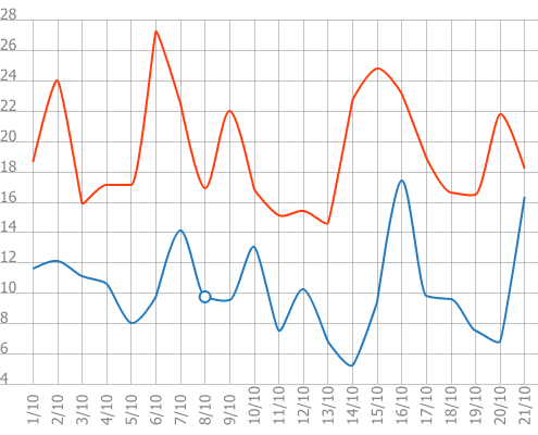

Converting weather2.svg with XnView Classic + RSVG-Convert results in a 32-bit PNG with a transparent background:
The black background you get probably depends on your configuration for viewing transparent PNGs. Please take a look at my “recommendations”.
Converting the 32-bit PNG to true color gets rid of the alpha-channel transparency:

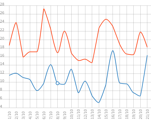

For comparison, MP's output is also a 32-bit PNG (but with an all white alpha channel), and it seems to use slightly different font settings:
Last but not least, there's the CadSoftTools plug-in:

marjohn wrote:The fonts are far from perfect in the PNG file after converting from SVG, but I don't have any idea what - if anything - can be done about that.
The typeface used in weather2.svg
<text class="text_tick" style="color: rgb(134, 134, 134); font-family: Source Sans Pro; font-size: 14px; font-style: normal; font-weight: 400; opacity: 1;" fill="#868686" transform="rotate(-90 454.69 340)" x="421.6905" y="354"><tspan x="421.9505" y="354" dy="0">21/10</tspan></text>
… is Adobe's Source Sans Pro:

I installed all fonts in \source-sans-pro-2.020R-ro-1.075R-it\OTF\ via Control Panel to make them available system-wide.
However, this doesn't make a difference when converting with XnView Classic & RSVG :-|
Results for conversion of weather2.svg with XnView MP: “Source Sans Pro” not installed vs. installed
