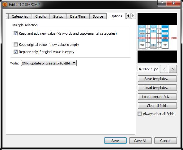

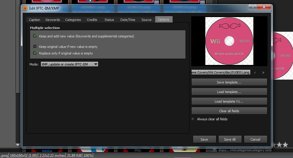

The only thing I can think of is maybe you don't have settings set right under: (Options tab), inside the batch process dialog.
Option Inside the edit dialog v0.83

Erixx haxx wrote: The only thing I can think of is maybe you don't have settings set right under: (Options tab), inside the batch process dialog.
I must admit that I never found my way to this option page on the very far right end of the dialogue :o
So, I changed the settings according to your screenshot, tried it and .... bingo :D
After having checked that these settings are global and permanent, my problem seems to be solved now.

The recommendation for the settings in the screenshot above have at least helped on my side, but I don't know if they work differently depending on other settings, e.g. in main preferences | meta data | XMP - IPTC.
The only thing that is still not working on my side is replacing a value. E.g.
- If I add a copyright note the first time, everything works o.k.
- If I want to modify an exisiting copyright note for multiple files, i.e. choosing another one in the dialogue or editing the existing one manually the old value remains.
If I do this for a single file it works
However, in case I have to update a field in multiple files, I can do in two steps. First delete the field content in the dialoge and press "Save all", then select or enter a new value and again press "Save all".

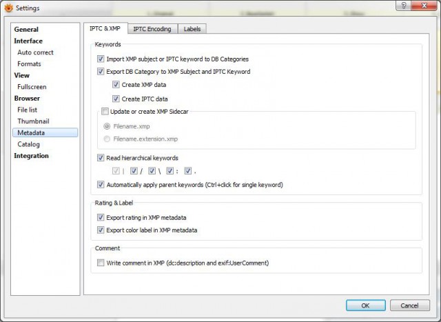

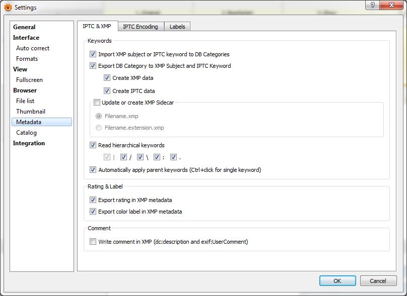

Here are my current settings, may be it helps.
Options page of Edit dialoge for IPTC/XMP
Meta data section form main settings
--For this I think you need to uncheck the 3rd option. Also Note: You may need to change modes (Pull down) depending on is it to change iptc or xmp.
I believe these settings only effect edits done inside this dialog..
