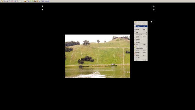

Hello there,
is there a way to put a button for "switch to browser-mode" into the Right-Mouse-Button Context Menu? Please see attached JPG...
Or maybe an autohide-option for the toolbar in fullscreen mode would be even cooler?
Thank you for helping...
Kind regards

ISTM that you have two separate requests here:
The second is:
Welcome among us!
This is 1st. I think that a much quicker way to switch is to middle click or double click on the image in the FullScreen mode. For this to work, you must configure it appropriately in Tools | Settings | Interface | Switching mode. Of course, you can use the keyboard to switch but it seems that you want a mouse-only solution.is there a way to put a button for "switch to browser-mode" into the Right-Mouse-Button Context Menu? Please see attached JPG...
The second is:
Currently not possible. What do you want to achieve? More space? IMHO the toolbar is pretty thin.Or maybe an autohide-option for the toolbar in fullscreen mode would be even cooler?

Re: Browser Context Menu Item In Full Screen Modus
Thank you for registering here and your request, digiformer.
In order to switch from fullscreen back to browser you can select "Fullscreen" in the context menu (not very intuitive, I know).
The settings for switching modes (Settings: Interface | Switching mode) might be also interesting for you. E.g. you could set "Use double click to switch between:" to "Browser <> Fullscreen | Viewer <> Fullscreen" and then use double-click to switch between fullscreen and browser.
