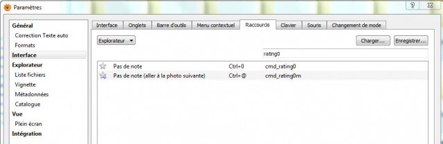

Using 0 on the keypad works fine to clear rating.
However the 0 on the top keys are not recognised with french keyboards ('Ctrl+Shift+0' in this case), even if set in the Shortcuts setup.
Here below, tentative to use it to clear and move to next picture - ignored by XnView:
Daniel, happy user for 20 years, to manage photo and videos and share them in slideshows (Windows 11, Linux Ubuntu and Android)

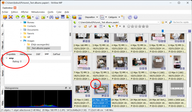

However, Ctrl-Shift-0 on the french keyboard still doesn't work. But... I found something interesting at least as a workaround:
Here is a workflow to (try to) reproduce:
1) Open an image in View mode, either one having a ranking or you just set a ranking
2) Press Ctrl-Shift-0 to remove the ranking (nothing visible happens)
3) Press Ctrl-S
4) Go to next/previous picture: The rating is removed
Note: This is not 100% and having tried dozen times there is a point where the above doesn't work anymore (even closing/restarting XnView). Sometime going to another folder, sometime doing a change before pressing Ctrl-S help. I feel there is something linked to the catalogue. When leaving the view mode, the star and XMP attribute isn't updated immediately. Selecting another thumbnail and move back updates both. I've even see an XMP rating=0 and the blue star still (screenshot below). Good luck!
3) Press Ctrl-S
