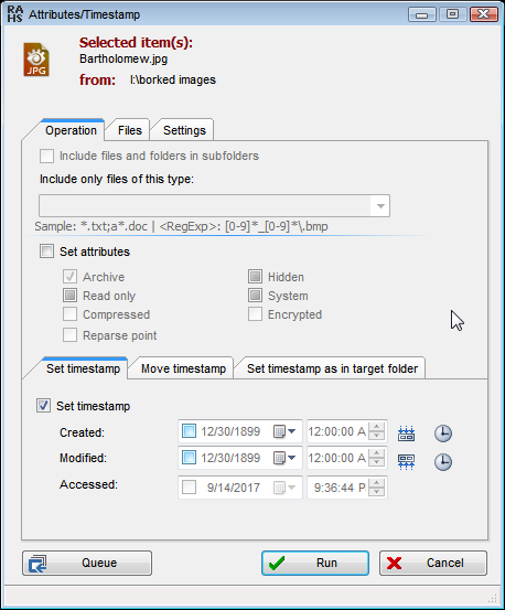

That's it! I did the same test. I used FC and changed the Created and Modified dates - which were what got borked - I believe from the drag-n-drop process between FreeCommander and XnView MP (in my other thread). Obviously, 1899 is not a valid date.
When I changed them to today's date, voila! XVI32 had no problem, and ALSO MP could view the file normally!
So, I've successfully gone back and unborked everything! And now that I know what the problem is, I can unbork them anytime I like.
Now, I am quite sure that I borked all these images by dragging them from FC into MP.
I have some other images that are borked, and the even the "Accessed" attribute got borked - FreeCommander doesn't enable the box for me to set that (that is a different problem, different program, however), so I'm trying to figure out how to fix that, too.
