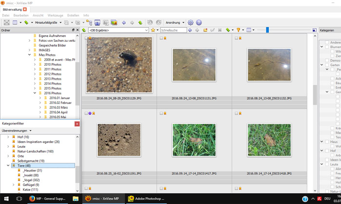

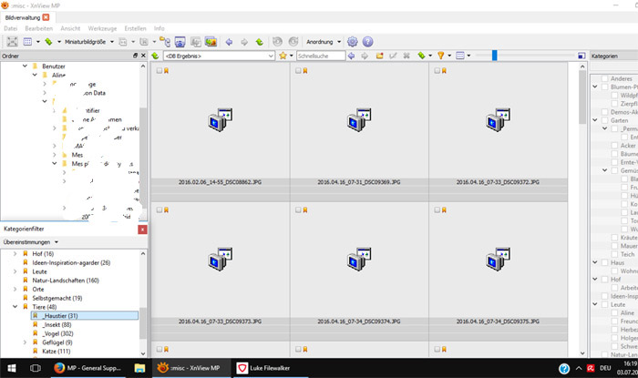

I have a problem with my categories. I guess I did something wrong without noticing. When I click a Picture it doesn't show its category any more (in the panel on the right).
In the category filter the pictures are still there, but I cannot open them (they are shown either specially small or not shown at all (see scrennshot).
What happened and how can I repair this?

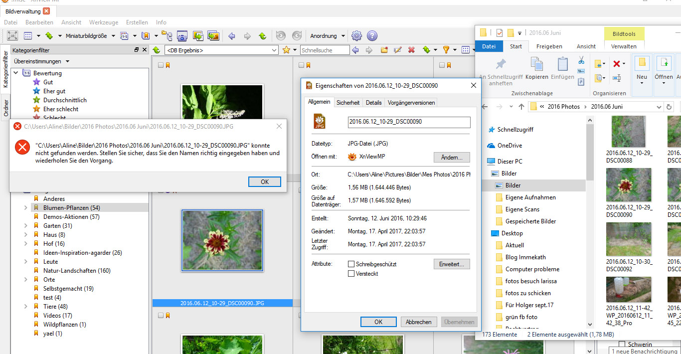

For the path problem I made another screenshot when you can see on the left the message when I try opening an image from a category folder in xnview (it says "xxx couldn't be found. Please be sure you entered the right name and try again"); on the right the image path when I open it with windows. I can see that the path is not the same: C:\Users\Aline\Pictures\Bilder\Mes Photos\2016 Photos; "Pictures" and "mes photos" are missing in the path from xnview. But I still don't know how to fix it!

It seems that you have change the path of your photos in windows explorer. You can modify the catalog by using Settings>Catalog>Relocate. Choose the path (C:\Users\Aline\Bilder\2016\) and enter the new one (C:\Users\Aline\Pictures\Bilder\Mes Photos\2016\)For the path problem I made another screenshot when you can see on the left the message when I try opening an image from a category folder in xnview (it says "xxx couldn't be found. Please be sure you entered the right name and try again"); on the right the image path when I open it with windows. I can see that the path is not the same: C:\Users\Aline\Pictures\Bilder\Mes Photos\2016 Photos; "Pictures" and "mes photos" are missing in the path from xnview. But I still don't know how to fix it!

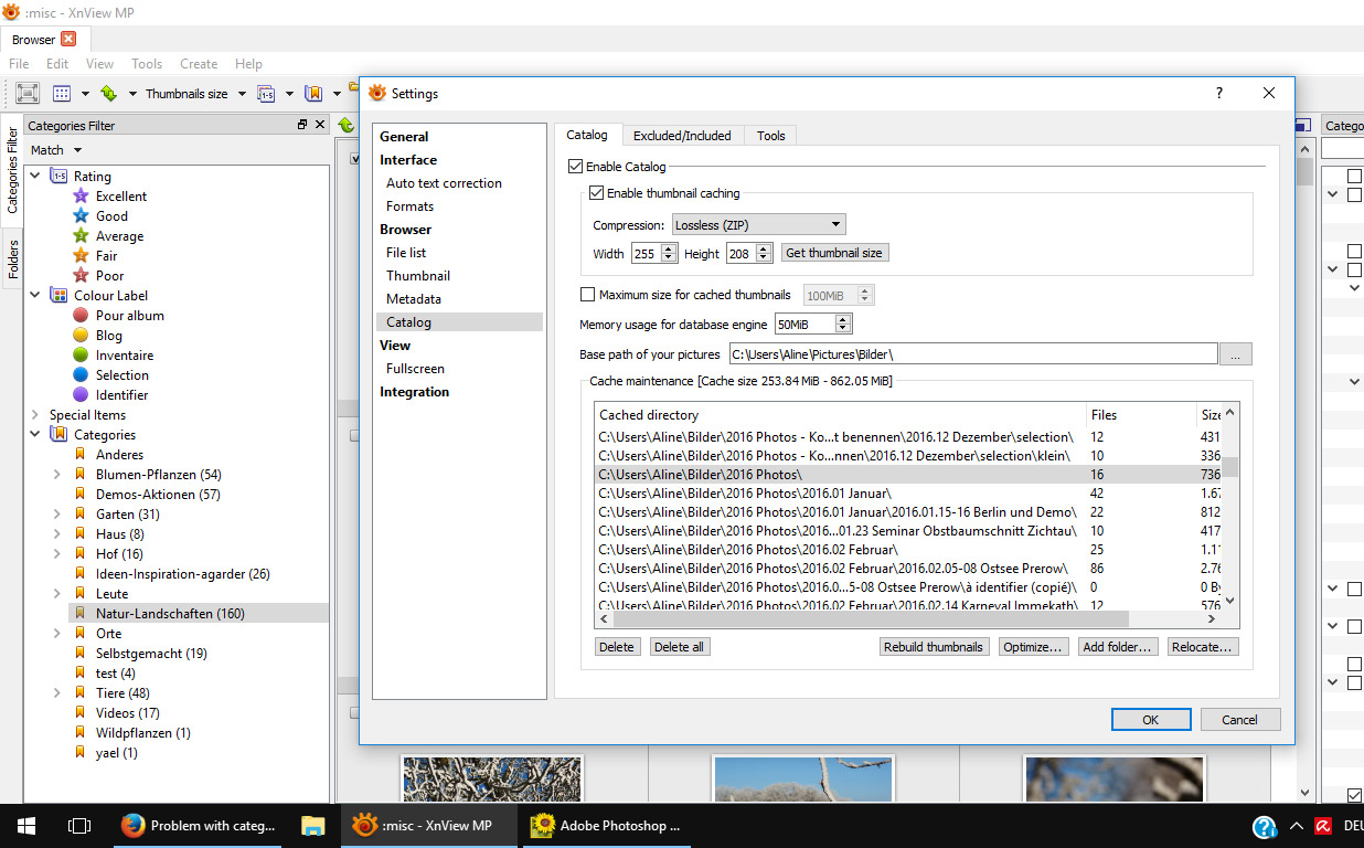

I just tried to change the path in the catalog but it still doesn't work, or I still didn't understand..
I also wasn't sure where exactly I should change the path; I changed the "Base path of the pictures" but it didn't have an effect. Then I tried to change in the "cached directory" with "relocate" but nothing happened.
Or is it still somewhere else that I have to change?

No; but now I changed it from "C:\Users\Aline\Bilder" to "C:\Users\Aline\Pictures\Bilder\" because I thought this was the right new path.xnview wrote:Did you use 'base path' before?
No, but I'm also not sure where in the long list I should change something; I tried for example to change the line " "C:\Users\Aline\Bilder" in "C:\Users\Aline\Pictures\Bilder\": I selected the line, clicked "relocate", wrote the new path in "new path" and clicked ok. But after this the line didn't changed, it still showed the old path.. so it also didnt change anything with the categories.xnview wrote: Nothing change with categories?
