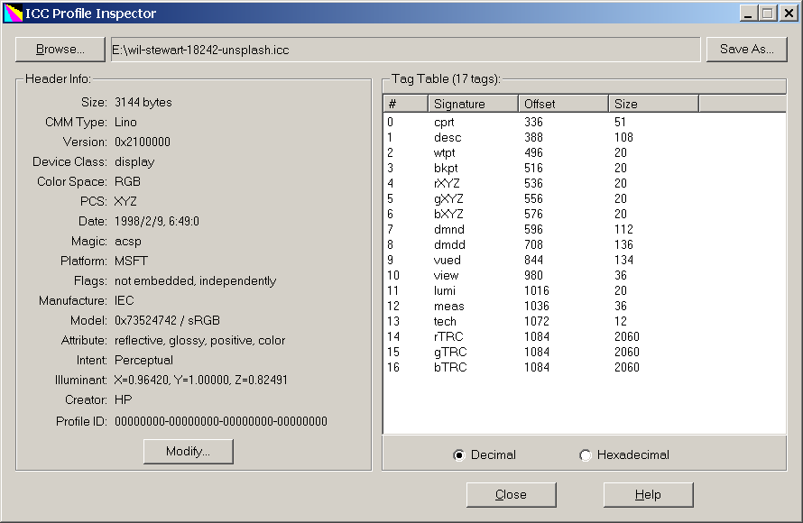

@Pierre: Could it be that HP's “known incorrect sRGB profile” (sRGB IEC61966-2.1) is the culprit (again)?
############ PS ############
JPEGsnoop: “Profile not embedded” & “Profile can't be used independently of embedded”
*** Marker: APP2 (xFFE2) ***
  OFFSET: 0x00000014
  Length          = 3160
  Identifier      = [ICC_PROFILE]
    ICC Profile:
      Marker Number = 1 of 1
        Profile Size                      : 3144 bytes
        Preferred CMM Type                : 'Lino' (0x4C696E6F)
        Profile Version                   : 0.2.1.0 (0x02100000)
        Profile Device/Class              : Display Device profile ('mntr' (0x6D6E7472))
        Data Colour Space                 : rgbData ('RGB ' (0x52474220))
        Profile connection space (PCS)    : 'XYZ ' (0x58595A20)
        Profile creation date             : 1998-02-09 06:49:00
        Profile file signature            : 'acsp' (0x61637370)
        Primary platform                  : Microsoft Corporation ('MSFT' (0x4D534654))
        Profile flags                     : 0x00000000
        Profile flags                       > Profile not embedded
        Profile flags                       > Profile can't be used independently of embedded
        Device Manufacturer               : 'IEC ' (0x49454320)
        Device Model                      : 'sRGB' (0x73524742)
        Device attributes                 : 0x00000000_00000000
        Device attributes                   > Reflective
        Device attributes                   > Glossy
        Device attributes                   > Media polarity = negative
        Device attributes                   > Black & white media
        Rendering intent                  : Perceptual
        Profile creator                   : 'HP  ' (0x48502020)
        Profile ID                        : 0x00000000_00000000_00000000_00000000
Stuffware Photo Studio:
│ Signature │ Offset │ Size   │ Type │ Value                                         │
│ cprt      │ 0x0150 │ 0x0033 │ text │ Copyright (c) 1998 Hewlett-Packard Company    │
│ desc      │ 0x0184 │ 0x006c │ desc │ sRGB IEC61966-2.1                             │
│ wtpt      │ 0x01f0 │ 0x0014 │ XYZ  │ X:0000f351 Y:00010000 Z:000116cc              │
│ bkpt      │ 0x0204 │ 0x0014 │ XYZ  │ X:00000000 Y:00000000 Z:00000000              │
│ rXYZ      │ 0x0218 │ 0x0014 │ XYZ  │ X:00006fa2 Y:000038f5 Z:00000390              │
│ gXYZ      │ 0x022c │ 0x0014 │ XYZ  │ X:00006299 Y:0000b785 Z:000018da              │
│ bXYZ      │ 0x0240 │ 0x0014 │ XYZ  │ X:000024a0 Y:00000f84 Z:0000b6cf              │
│ dmnd      │ 0x0254 │ 0x0070 │ desc │ IEC http://www.iec.ch                         │
│ dmdd      │ 0x02c4 │ 0x0088 │ desc │ IEC 61966-2.1 Default RGB colour space - sRGB │
│ vued      │ 0x034c │ 0x0086 │ desc │ Reference Viewing Condition in IEC61966-2.1   │
│ view      │ 0x03d4 │ 0x0024 │ view │ Unknown                                       │
│ lumi      │ 0x03f8 │ 0x0014 │ XYZ  │ X:004c0956 Y:00500000 Z:00571fe7              │
│ meas      │ 0x040c │ 0x0024 │ meas │ Unknown                                       │
│ tech      │ 0x0430 │ 0x000c │ sig  │ CRT                                           │
│ rTRC      │ 0x043c │ 0x080c │ curv │ Unknown                                       │
│ gTRC      │ 0x043c │ 0x080c │ curv │ Unknown                                       │
│ bTRC      │ 0x043c │ 0x080c │ curv │ Unknown                                       │
ICC Profile Inspector:
p151474.zip
wil-stewart-18242-unsplash.icc
(2.68 KiB) Downloaded 78 times
… and compared it to AdobeICCProfiles_end-user.zip\RGB Profiles\sRGB Color Space Profile.icm. They're 100% identical.

I believe there is no conversion from sRGB profile in the original .jpg, to the exported/saved/batch converted .tif
Unanswered Questions;
a) How Can I preserve the same exported exif and profile metadata Exporting in XnViewMP from .jpg to .tif ?
b) What is the reason why the image comparison programs in Linux all show non-identical pixels after XnViewMP export from .jpg to .tif ?
c) Should the results of tests I've done in this thread be different in Windows 7 Pro or later, vs. Linux ?
Best regards.

The results of your tests have shown that the conversion with XnView MP v0.90 isn't (fully) lossless, although it should be. Your settings seem to be correct. As you've pointed out, “no differences exist between the .jpg and the exported .tif” with ImageMagick. This tells me that we're dealing with a bug.
Software like XnView often incorporates code from 3rd-party libraries:
\XnViewMP\plugins\imageformats\qtiff.dll is based on LibTIFF.
Sometimes, issues stem from such libraries. Case in point: libpng & sRGB IEC61966-2.1
Unfortunately, I'm far from an expert when it comes to color management, which is why I'm hoping that users with calibrated systems – be it on Linux, Windows or Mac – will eventually share some insight.
PS: Could you please post a screenshot of ToolsSettings…GeneralICC?
