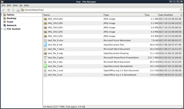

Screenshot_2018-09-24_21-02-03.png:
This screenshot shows a view (using a common Linux file browser) of a test directory where I've placed a few image files together with different test files in both OpenXML and OpenDocument formats. Note that the files are sorted by date in reverse order.

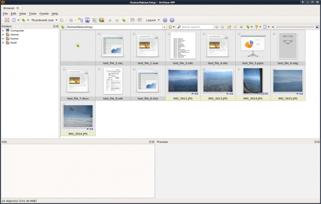

Screenshot_2018-09-24_21-04-37.png:
After taking the previous screenshot, I opened XnView (v0.92) en browser mode and I navigated to the same test directory.

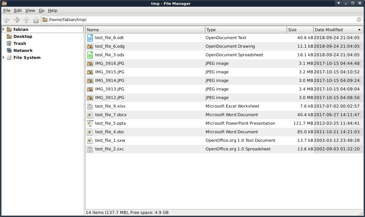

Screenshot_2018-09-24_21-05-06.png:
Once XnView finished generating the thumbnails (very fast in this case since the directory contains very few files), the modification date of the ODT files was changed to the current date and time (note how the three ODT documents they are now at the top of the sorted list in the file browser while the timestamp of the other office files remained unchanged.
