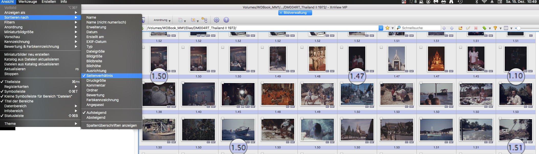

In the browser there is an option View > Sort by -- Ratio , does that enable you to see what you need?pvpp wrote: Mon Dec 17, 2018 9:31 am Thanks,
but I want to find out which pictures have a ratio format <> 1,5 or may be <> 0.66

Re: sort by ratio
Thank you for answer.
No, ist the same sort order.

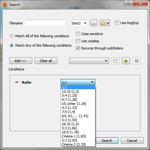

If you want to filter ratios, use Tools, Search, ... and add a condition
The only ratios you can filter are shown in the picture below.
If you want to filter other values, the only method is to sort photos by ratios, look for the ones you want, tag them, and then , filter with tags. (right click)

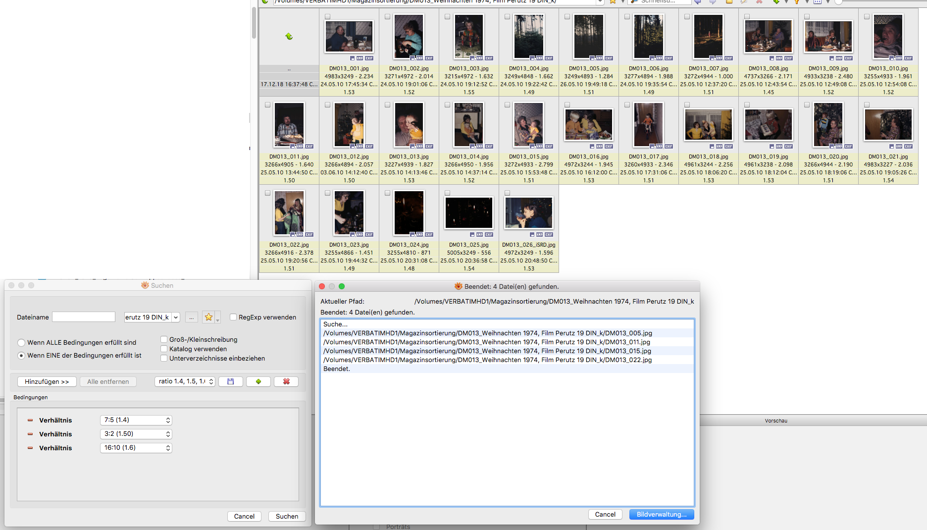

Yes it works, but I want pictures in a range between 1.4 to 1.6.
Otherwise I get just the right ratios: 1.4, 1.5, 1.6. or something like attachment.
