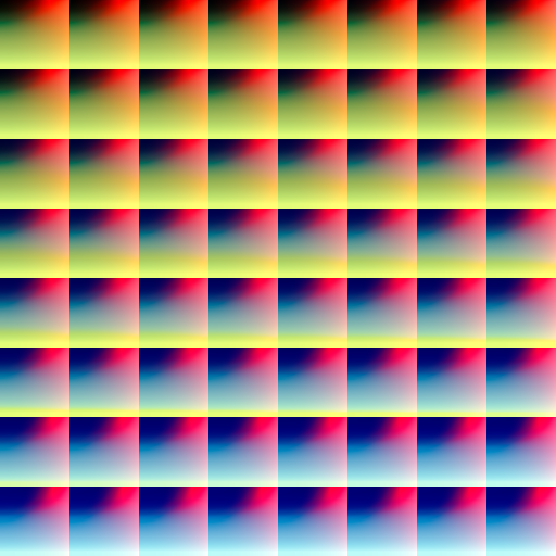

I've done a bit of twiddling and here's what I have found.
1. File names in the clut folder /XnView/AddOn/clut are important.
2. The "density" of the lookup PNG file is relevant - if you look at the different png files you'll see the ones for the simulations that crash are different.
To reproduce this I renamed the original Kodak Kodachrome 25 files to:-
lookup_k25.png and lookup_k25.thumb.jpg respectively
Started xnview, opened an image>Image>Film Simulation scrolled to k25 and clicked preview and got the most horrible result.
However with Preview and Apply to image it didn't crash.
As I mentioned previously I have downloaded the Rawtherapee CLUT library. In the /XnView/AddOn/clut folder there's a file called identity.zip I extracted the look_identity.png file, opened it in Rawtherapee, applied the Kodak25 simulation from their library and then exported the png.
Next I renamed the exported png to lookup_k25.png and used it to replace the original renamed version as above.
Opening an image on xnview and applying that filter did not crash, and the result looked OK.
By taking the same image and opening it in RT with the Kodak 25 simulation I get what seems to my eye to be the same result as using the modified and renamed files as above.
Need to do some more fiddling but getting there. I've attached the working versions - just put them in the clut folder - you may want to remove the original Kodak Kodachrome files at the same time.

- Attachments
- lookup_k25.thumb.jpg (5.91 KiB) Viewed 1573 times
- lookup_k25.png (205.3 KiB) Viewed 1573 times
Re: Film simulation crashes XnView
OK - following on from the above I have reworked the 5 film simulations that crash XnViewMP in linux.
In each case I have taken the lookup_identity.png suppliedby XnView's author.
Using Rawtherapee I have then applied the film simulation provided by Rawtherapee's HALD Clut download.
I then exported the result as an 8bit PNG then renamed to fit the convention that seems to be required in XnView.
Where the appropriate simulation was not in Rawthrapee I have loaded the 12 level identity file from the XnView clut into the Rawtherapee simulations folder, thus allowing me to use RT to apply those 12 level simulations to the 8 level identity.
According to http://rawpedia.rawtherapee.com/Film_Simulation this should be fine for photo work.
The attached zip should be extracted away from the XnViewMP clut folder, you'll need to manually remove the 10 files from there and then copy these new ones in.
Hope this is pretty self explanatory.
Hi. Sorry I took so long to reply.
I just tested your filters and they work. The older ones still crash, of course. But your will do.
Thank you for your kind attention.
