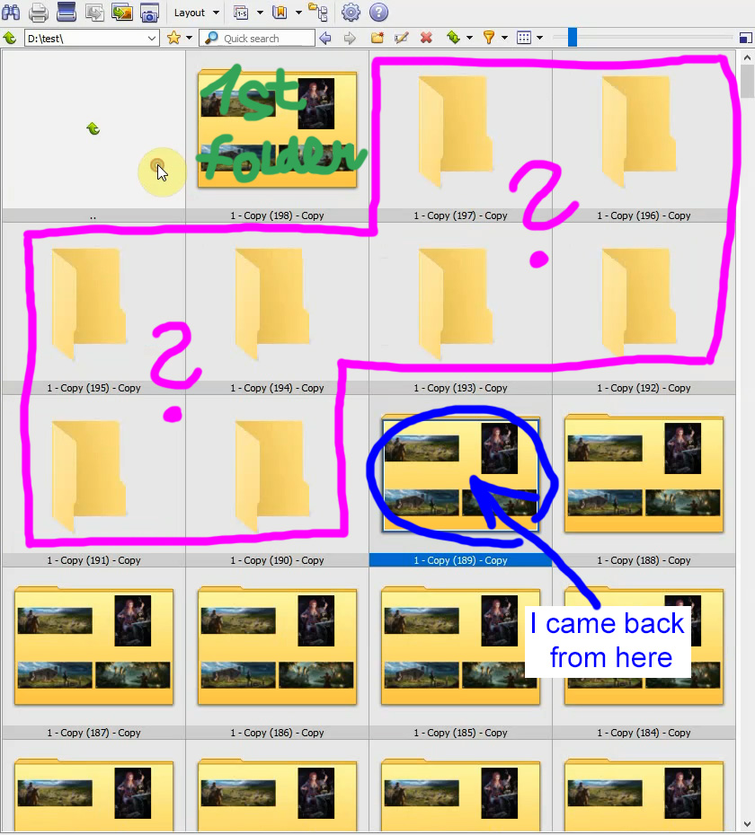

Below is a screenshot capturing folder drawing sequence. In a magenta-framed area the folders (with image thumbnails) appear with a delay. In the meantime you can see these open folder icons which will be replaced later by folder icons with thumbnails.

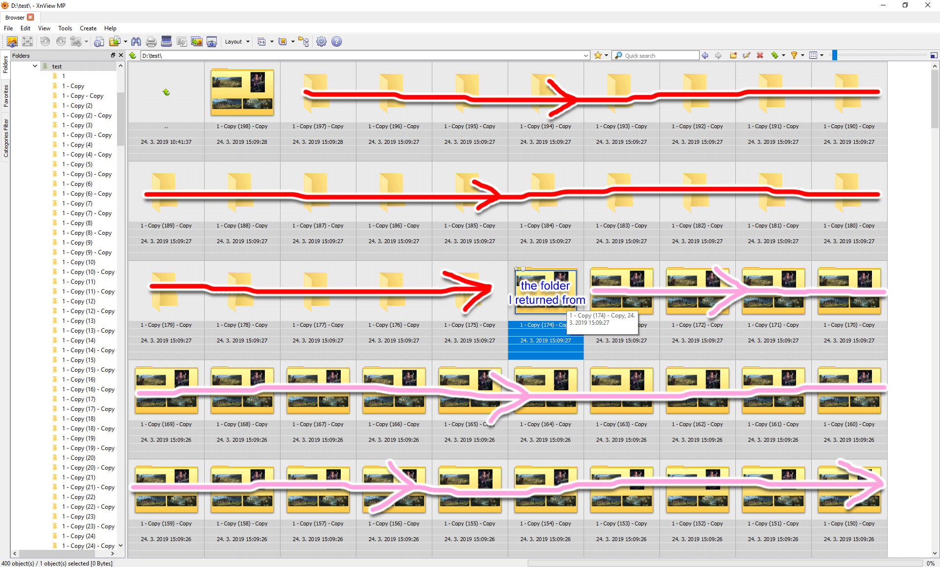

I use the portable version of XnView MP (64bit). The one you can download as the zipped program folder from your website. I tried today to extract XnView MP into different folder and start with clean "profile" (settings, cache). The folder blinking behaved that same on my test folder.

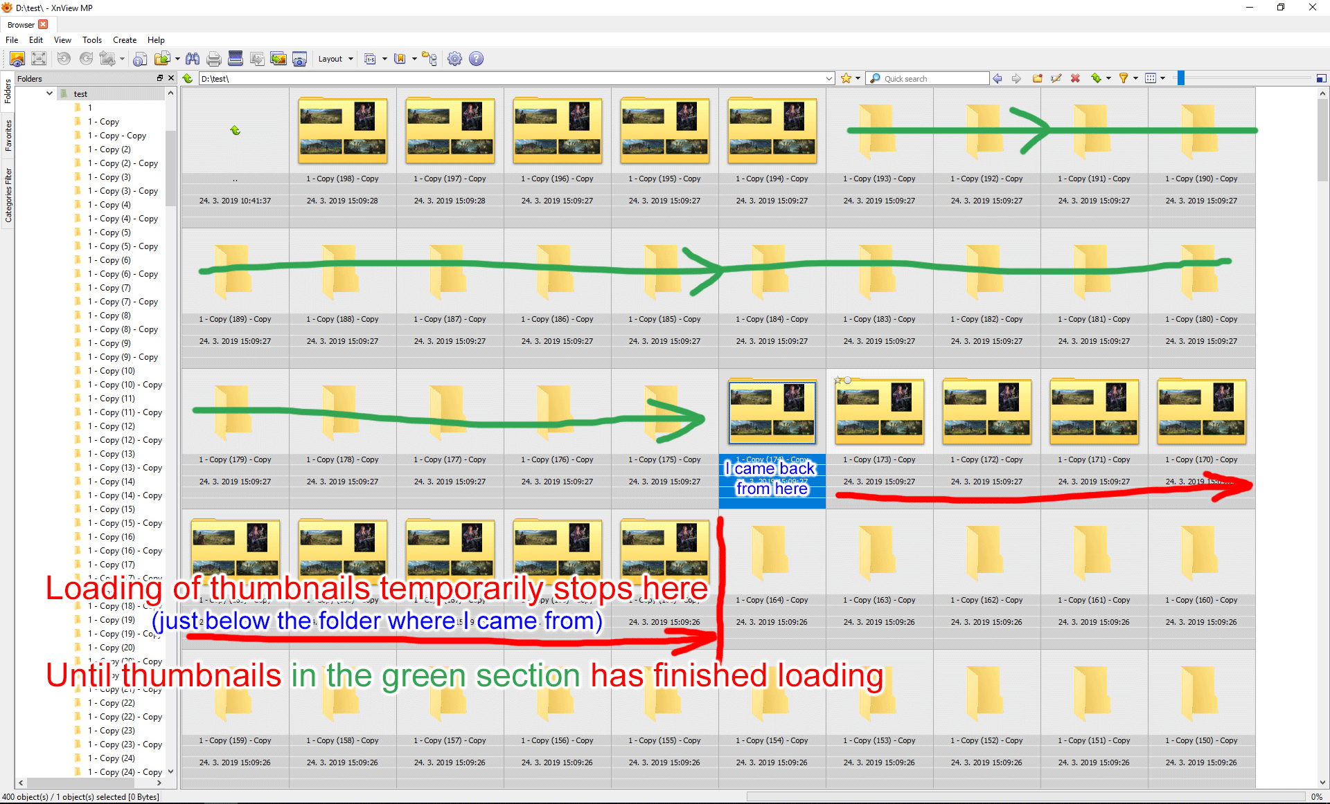

When I disabled the catalog (cache), closed the program and started it again, the drawing sequence of folder icons with a thumbnail view was different (see screenshot below).

I just want to add that the situation is a bit different when catalog (cache) is enabled (see screenshot below). In such case, the thumbnail folders marked with pink arrow will appear on the screen immediately (with no visible delay). Thumbnails of other folders marked with red arrow will appear on the screen with a delay (and perceived as blinking). The same behavior as described in my 1st (uppermost) post.
