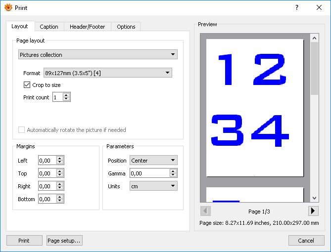

O.k., I just tried to reproduce your problem but failed: Order is fine for me.
What I did:
1. Select four image files (1-4) with differing orientations (Portrait + Landscape)
2. Select "File » Print"
3. In "Print" dialog select:
a.) Page layout: "Pictures collection"
b.) Format: 89 x 127mm (3.5x5") [4]
c.) Crop size: Checked
4. Select "Page setup..."
5. In Page setup dialog choose "Landscape"
6. Confirm with "OK"
Actual result = Expected result:
[1][2]
[3][4]
Could you please provide more details? Which format do you use? Is the preview erroneous, too? If yes, please make a screenshot which shows both settings and the wrong preview.

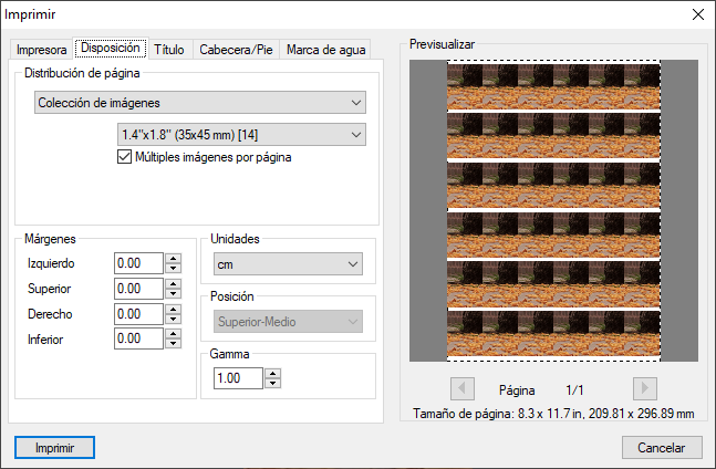

I updated to XnView 2.49.1. Thanks for all the work done.
Pictures collection
Depending on picture aspect ratio, page size and margins, we can get more or less miniatures.
Menu File, Print, tab Layout, Page layout: Pictures collection, field Format: option 1.4"x1.8" (35x45 mm) [14].
May be the number between square braquets ([14]) could be ommited.
Printing on a portrait A4 page with all fours margins in zero:
— With square or landscape aspect ratio (i.e.: 1:1 ■ and 2:1 ▄) we get an array of 4 by 8 = 32 miniatures.
— With portrait aspect ratio (i.e.: 1:2 █) we get an array of 6 by 6 = 36 miniatures.
Printing on a landscape A4 page with all fours margins in zero the results are inverted.
if we give some margin, the numbers of miniatures also can be different.
