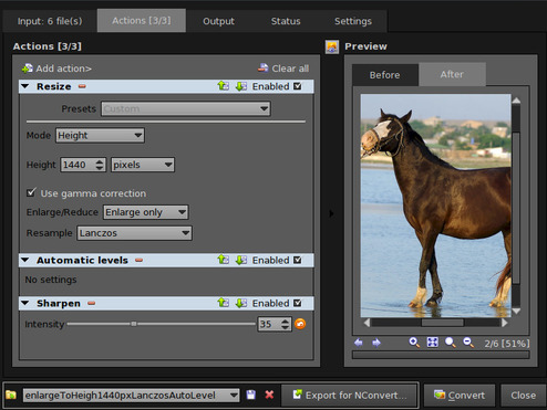

xnview wrote: Thu Nov 21, 2019 2:44 pmdo you use 'actions'?
Yes. I had been using one: "Level". Sometimes I was using a "scritp" of three actions: a resize, autolevels and sharpen, that I had saved as a script (see below).

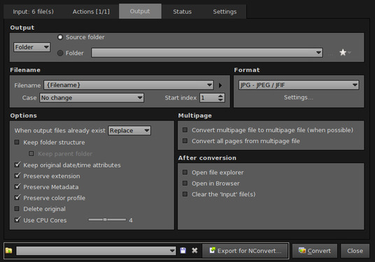

do you use 'core' option?
Yes, the "Use CPU Cores" version is checked, "Use CPU Cores: 4 ". I think this was like this by default when I upgraded to 0.94 because I don't think I checked that, at least not in 0.94. I may be wrong. I know that in 0.93 whenever I tried the cores, I got an error that I don't remember, something like I couldn't use that option if I had selected something else, but it didn't bored me, so I just didn't use the cores option, I thought I would see some other day what configuration needed to be changed.
Do you think I should try without this option checked?
could you post a screenshot of 'output' tab?
See the output tab and also the actions tab:
output tab
output tab
actions tab
actions tab
