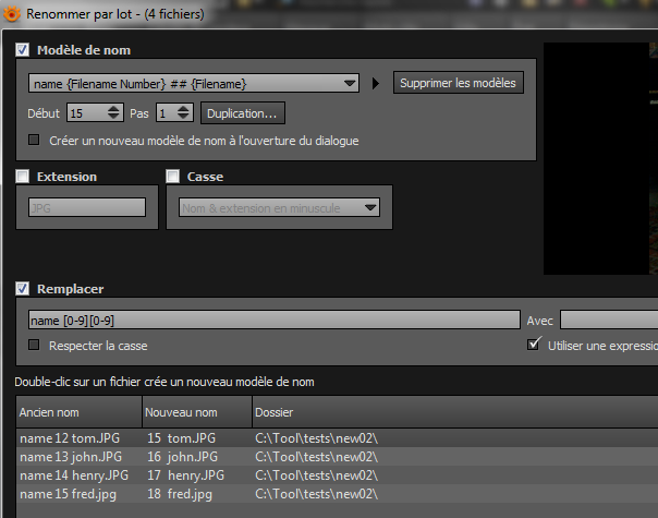

- Select only the files you want to rename,
-Tools, Batch rename
-Apply the settings shown in this picture
- OK
- Then, run another batch rename to add "NAME" at the beginning of file names
with only Name {filename} in the first field
(by checking / unchecking "Replace" you can understand how it works )
Edit: Go to next message for new version.
- OK

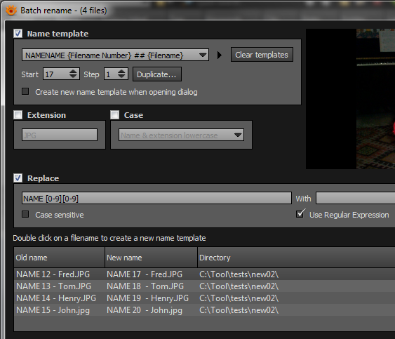

NEW: Wild cards with renameing
NEW VERSION one shot
- Check that the sort order is correct.
- use : Tools, Batch rename
- Apply the settings shown in this picture
- Check if new names are right
go
go

Re: Wild cards with renameing
michel
Thank you.
That is how I am doing it at present.
I do realise the potential for a bit of a bloodbath, but was hoping to be able to do mixed blocks.
Regards
Thank you.
Regards
