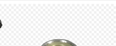

My question is more about Background. When I see a raw image, the back ground is white. Now, when I open that image with Xnconvert (the UI) it does this:
(See the image attached.)
XnConvert places a pattern on the white space. Is there a way to do that with the command line utility NCONVERT?

The checkerboard pattern in the image you posted above indicates transparency, do I understand that you are trying to apply a watermark file (also with transparency) to that file?
When loaded in XnConvert the image displays as above in the preview, but have you tried watermarking the image in that program?

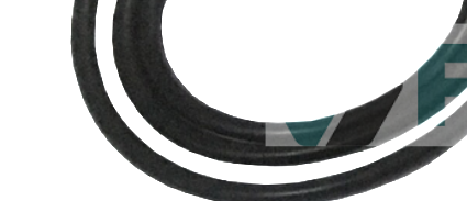

Maybe it is the image viewer I am using. Do you see how that corner of the watermark is "gone"?

The problem is that the top-left part of the small image on the right is white rather than clear, presumably?
It looks as it the 'watermark' image is behind the main image, possibly you need to reverse the images so that the watermark is in front, if that makes any sense? You could possibly try reversing the 'watermark' and 'main' files in your script and see the effect.

No switching the files does not work. The entire image is cropped to the size of the watermark. No not right.
Yes, the watermark is placed in front and is transparent. That seems to work.
But some of the watermark is become lost (covered??) in the white space, as I showed in the image. The left corner of the transparent watermark was missing.

But, there is a real problem in what image viewer is used. The new Windows 10 image viewers are worse than the old Paint program.
(how does Microsoft constantly makes things worse?)
It is the new Win 10 viewer that shows the watermark partially missing (in my attached image). In the old Paint program and the Xnviewer, the converted image looks pretty good. Although. I need more transparency for the watermark, that watermark is completely visible.
Man, this is complicated.
You know, I think it may be working as expected now.
