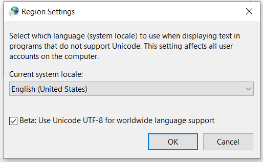

If i turn off
unicode utf-8 for worldwide... (current sys locale - different) - all pdf's opens well.
jSer
Posts: 9
Joined: Fri Nov 29, 2019 9:46 am
Re: Some pdf are not recognized
Post by jSer »
Something wrong with locale/filename/path managing... if "unicode utf-8 for worldwide" is on.
Pdf's with filename or filepath in non english locale - problem.
But if rename it to "1.pdf" or/and move to "d:\" all works perfect.

Again, if utf-8 locale turned on in win 10 and filename in non english locale, XnView cannot open it!!!
XnView 2.49.3, GS 9.52.
If rename file to 1.pdf or s.pdf - all fine.
