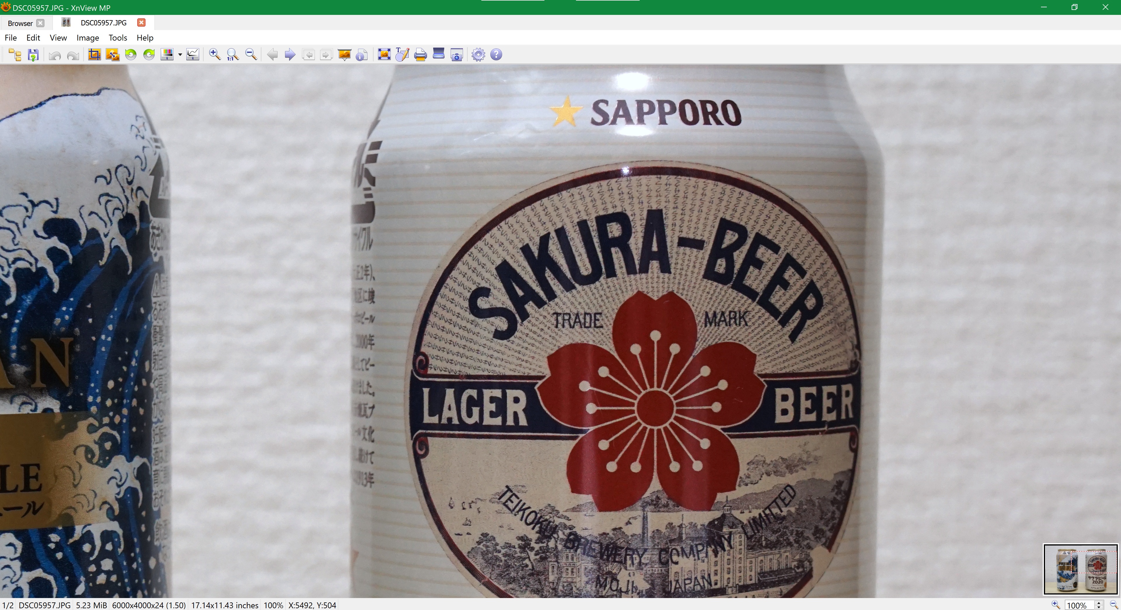

I just had this issue too, on a UHD (4K) display laptop. Try going to Settings, View, and UNCHECK "Zoom on HiDPI screen: 1 image pixel equals 1 screen pixel." That stopped the problem for me. I'm using Version 0.96.5 64bits (Aug 17 2020).
Unfortunately, this workaround means that smaller images will not fill the whole viewer window without being zoomed in, so hopefully this can be fixed in a future update?
My Windows Display Settings Scale is set at 225%, in case that makes any difference (I doubt it because I didn't have the issue on a 1080p display scaled at 125%).
With Zoom on HiDPI UNchecked. Zoom works as intended. The image area in the viewer matches the area in the dotted box in the zoom box at the bottom right.
With Zoom on HiDPI checked. Look carefully at the zoom box at the bottom right - the area selected by the dotted line is all the way to the right of the picture but the viewer shows the left side of the picture. I can't move it any further down or to the right.

Yes, as far as zoom goes it works fine if unchecked. The downside is that when viewing at the default zoom, images smaller than the resolution of the monitor don't fill the whole screen. I suspect that the issue isn't actually the dpi or dot pitch of the monitor itself, but rather something about that setting interfering with how zoom in works.
If it is possible for the program to ignore (or always treat as unchecked) that setting whenever the zoom is more than 100%, that would probably fix the issue. When zooming in manually to part of the image, I don't think you lose anything if the setting is disabled.
