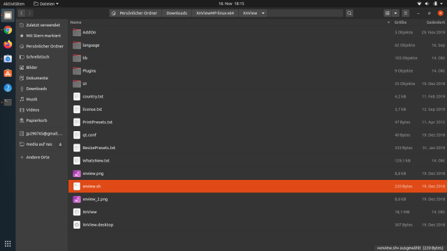

I copied the XnViewMP-linux-x64.tgz from here https://www.xnview.com/de/xnviewmp/
unpacked in the dowload folder but there wasn't a "opt" directory
see attached screenshot
a double click on xnview.sh opened the text editor
no "open, execute or cancel" request
But anyhow: I just tried again a doubleclick on XnViewMP-linux-x64.deb and all of a sudden it started!
Don't ask why. :-)
Thanks anyway! Cheers Jens
