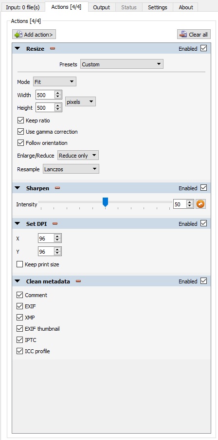

Thanks, I did a little bit of For /r work.
When I use XnConvert, the conversion result is fine with me.
Then I click on the "Export for NConvert" button.
I get the text that I paste into the bat file.
After executing the bat file, the conversion takes place, but the image is different from XnConvert
Why?
Why?

Hi.
I have attached four images.
Original.jpg (297kb) is the original image Resize_NConvert.jpg (409kb) - this is converted by NConvert Resize_XnConvert.jpg (15) - this is converted by XnConvert Settings_XnConvert.jpg (73kb) - XnConvert conversion settings I convert in the same folder where the image is located, replacing the original
To convert using NConvert, I used the command:
@chcp 1251
@for %%A in (D:\images_Test\*.jp*) do "D:\NConvert\nconvert" -ratio -rtype lanczos -rflag decr -rflag orient -resize 500 500 -sharpen 50 -dpi 96 -clean 95 "%%A"You do not have the required permissions to view the files attached to this post.

The main difference is that the NConvert image pixel dimensions are not as expected, 500 x 500px?
Also the JPEG quality of the XnConvert image is 70, but the quality of the NConvert image is 85, the default value, as you don't have a -q 70 term.
Are there any other relevant differences?

I have done some tests and determined that the -resize option, which seemed to be the likely cause of your problem, operates correctly.
But testing using the following NConvert code used in your For loop:
...the code runs as expected producing a 500x500px image until the -clean 95 option is added, it then doesn't run.
Looking at the NConvert help file, -clean 95 is not valid code, the 95 is not a valid value.
But the JPEG 3000x3000px output you reported has not been reproduced, unexplained, so you should probably examine your code and retest.
NConvert_x64_7.70\nconvert -ratio -rtype lanczos -rflag decr -rflag orient -resize 500 500 -sharpen 50 -dpi 96 -clean 95 Original.jpg...the code runs as expected producing a 500x500px image until the -clean 95 option is added, it then doesn't run.
