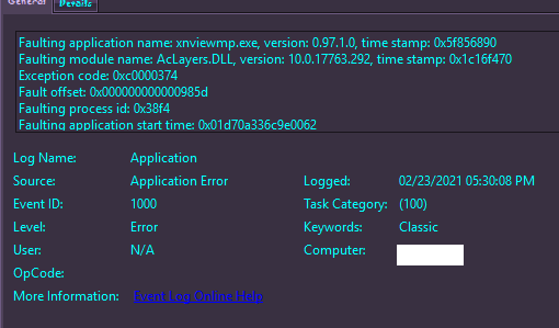

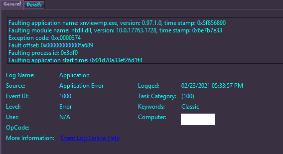

i'm having an issue with the program (0.98 & 0.97) crashing while several images are loaded up (More than 4, sometimes from different folder locations). This behavior used to not happen in the past, but as of recently, it's happening more than it ever did and it's making the program unusable...I collected some screenshots from the event log on my system and I have a dmp file, but before you look at it, could you take a look at the screenshots please?
anyone know what nt or aclayers is?
nt.dll
aclayers.dll
The program used to load lots of images before, so I'm not sure what's causing it to behave this way...deleting the files in roaming, reinstalling it did not help at all - as you can see, the problem occurs when multiple tabs are opened. In specific, these imaged tabs are loaded from different trees...
