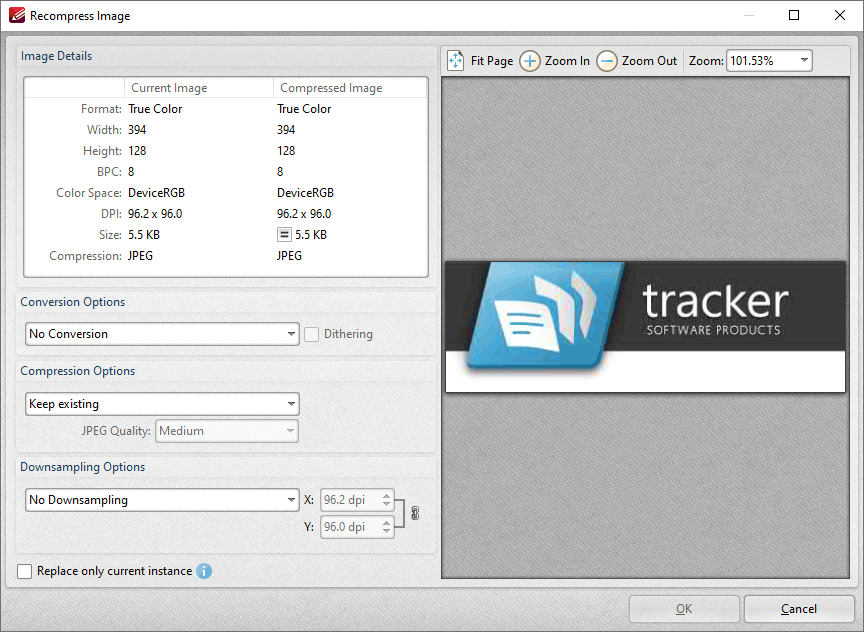

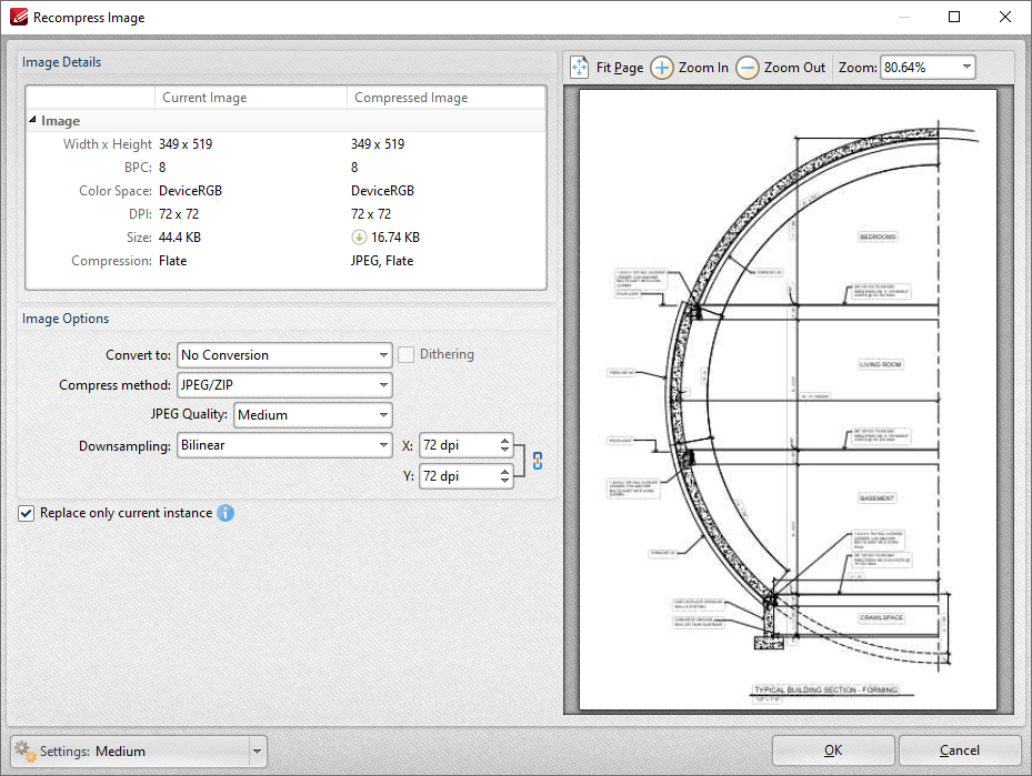

Re: Converting a multi-page PDF to a multi-page PDF
Command-line tool: Poppler for WindowsIxenPDF wrote: Thu Apr 01, 2021 7:35 amSo how can I find out the real properties of my pictures that are in my pdf? Is there any third party tool, that can do this?
GUI: PDF-XChange EditorXnTriq wrote: Tue Feb 21, 2017 6:00 pmpdfimages.exe -list 'Das_erfolgreiche_Bewerbungsgespräch-72 s-w extr 11.pdf' wrote:Code: Select all
page num type width height color comp bpc enc interp object ID x-ppi y-ppi size ratio -------------------------------------------------------------------------------------------- 1 0 image 550 851 gray 1 1 ccitt no 3 0 72 72 12.9K 23%pdfimages.exe -list lösch.pdf wrote:Code: Select all
page num type width height color comp bpc enc interp object ID x-ppi y-ppi size ratio -------------------------------------------------------------------------------------------- 1 0 image 2835 2209 gray 1 1 ccitt no 9 0 300 300 71.9K 9.4%
