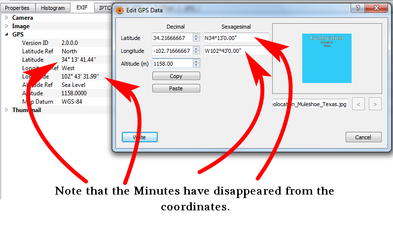

I have used the XnViewMP GPS Editor extensively.
If I manually type in the decimal coordinates and enter the Altitude at the same time = it works with pinpoint accuracy.
If I type in the decimal coordinates and Altitude manually and "Copy" BEFORE I write the coordinates to the file(s), it will copy the coordinates correctly and paste them into other files correctly.
HOWEVER, and this is wherein the fatal flaw lies, in the GPS Editor, there are two columns of coordinates, Decimal and Sexagesimal; when I open the GPS Editor to edit/correct a file that already has coordinates, the Sexagesimal coordinates will have the minutes rounded to all zeros and the Decimal coordinates will reflect this rounded off position, even though the pinpoint accurate coordinates are showing accurately in EXIF data.
1. If I copy the coordinates of a file that already has the coordinates written, it will copy the rounded off coordinates instead of the accurate coordinates, and then paste the Decimal coordinates adjusted to the rounded off Sexagesimal coordinates, instead of pasting the correct accurate Decimal coordinates.
2. If I edit the Altitude of a file that already has accurate GPS coordinates, either by adding a missing Altitude or correcting a wrong Altitude, when I "Write", it will acknowledge the corrected Altitude, BUT replace the accurate Decimal coordinates with coordinates to match the rounded off Sexagesimal coordinates.
This behavior throws off my pinpoint accurate GPS coordinates by miles.

MORE INFO:
I have found that, if I wish to preserve the accurate coordinates when editing in the GPS editor, or wishing to copy the accurate coordinates, I must refer to the EXIF data and replace the rounded off coordinates with the accurate coordinates manually; otherwise, instead of the accurate coordinates, it will copy the rounded off coordinates.
This behavior really slows things down.
BuckSkin
- Posts: 138
- Joined: Thu Aug 18, 2016 4:09 am
Re: Flaw in GPS Editor
I said "Minutes" when I should have said "Seconds"

I updated to version 0.98.3 and that seems to have the problem cured.
As an added benefit, always before, when copying coordinates, it did not copy Altitude; now, all coordinates Copy, including Altitude.
