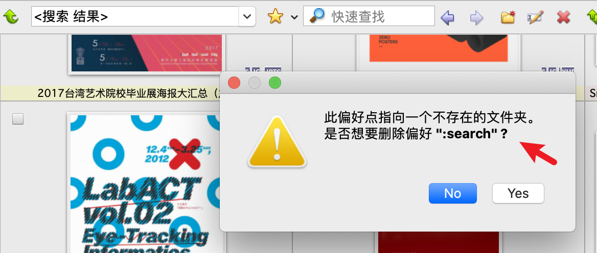

When I open a saved search, XnView prompts: This is a non-existent folder, do you want to delete it?
I have some fixed searches that I want to save so that I don't have to repeat the text and set the same criteria when looking for the same image. Because an image has many attributes and it can only be put in one folder.
I have very good image naming habits and by searching for keywords, I can find the images I need. So I would really like XnView to save the search criteria. I believe many users who manage a lot of images will have the same needs as me.
