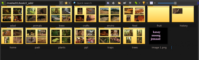

I actually made a rough hack, creating a new image and using the Draw tool to set color and add text -see the lower right black icon below.

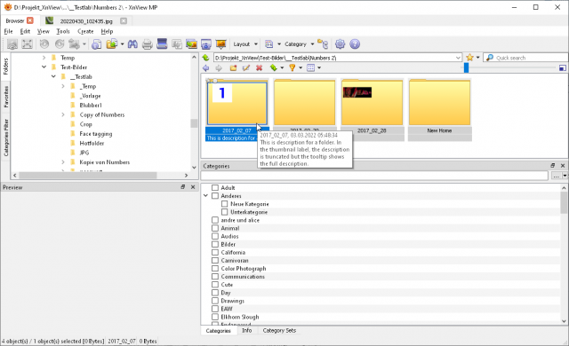

Both XnView MP and XnView Classic support so-called descriptions (Field: <Annotation>). You can add a description to any file and even folders. The descriptions are stored in a file named "descript.ion". Descriptions can be displayed as thumbnail label for example.
This is what it looks like: Below please find the steps to get this up and running.
Preparation: Adding description/annotation to thumbnail label
1. Start XnView in browser mode.
2. Select "Tools > Settings" or press F12 key to open XnView's settings.
3. Switch to "Browser | Thumbnail | Labels".
4. Add a custom label (e.g. Custom 3) by selecting the entry on the left and clicking on the ">" arrow.
5. Select the added entry "Custom 3" and either enter "{Annotation}" into "Custom label" or click on ">>" and select "Annotation".
6. Close settings with "OK"
7. In XnView browser make sure you see thumbnails and labels (menu "View > View As > Thumbnails + Labels")
Adding a description/annotation to a folder/file
1. In file list select a folder or a file.
2. Select "Edit > Edit comment..." menu or press Ctrl+D.
3. In field "Description" enter a message that you want to be displayed.
4. Select "Write" to write the description. XnView will create a file "descript.ion". Please note that this is a hidden file.
When browsing the parent folder you should see your description as thumbnail label.
