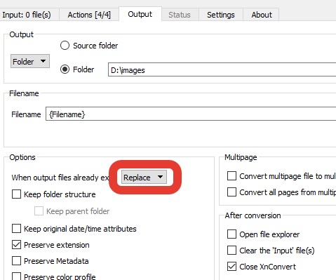

I still can't find the parameter of this button:

agdabn wrote: Wed Mar 03, 2021 9:46 pm I still can't find the parameter of this button:
The new file will replace the existing file if you use the -D option suggested earlier... :D
  -D                : Delete original picture
Always test with copies of files!
I'll look again at the rest of your post later.

In this case,- D will not help.
After all, the original file is located in a different directory. And the replacement is necessary in the Output folder. I.e. if there is already a file with this name in the Output folder, then it must be replaced.

agdabn wrote: Wed Mar 03, 2021 10:20 pm In this case,- D will not help.
Alright, not the same thing... :(
Maybe this option, I've never used it, or even noticed it before:
 -overwrite        : Overwrite existing file

YES, super
Thank you very much.
Now everything works as it should. Final variation:
@chcp 1251
@for /R "D:\images_Input\" %%I in (*.jp*) do D:\NConvert\nconvert -ratio -rtype lanczos -rflag decr -rflag orient -resize 500 500 -sharpen 50 -dpi 96 -q 70 -overwrite -rmeta -rexifthumb -o D:\images_Out\%%~nI %%I
