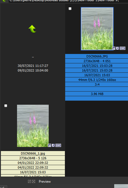

xnview wrote: Sun Jan 09, 2022 3:14 pm i've tried your 2 files, and the orientation is correct
Do you have an idea why it is not here? It still looks like in my screenshot above. In browser view only DSCN0666_1.jpg is portrait and the exif rotation icon is displayed.

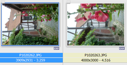

It is really weird here. Have a look at this
This is also after rebuilding the catalog, no matter whether "use embedded thumbnail" is active or not.
Why is there the described difference between rotating in browser and image view? The latter creates the issues here. Rotating in browser view without save dialog works fine.

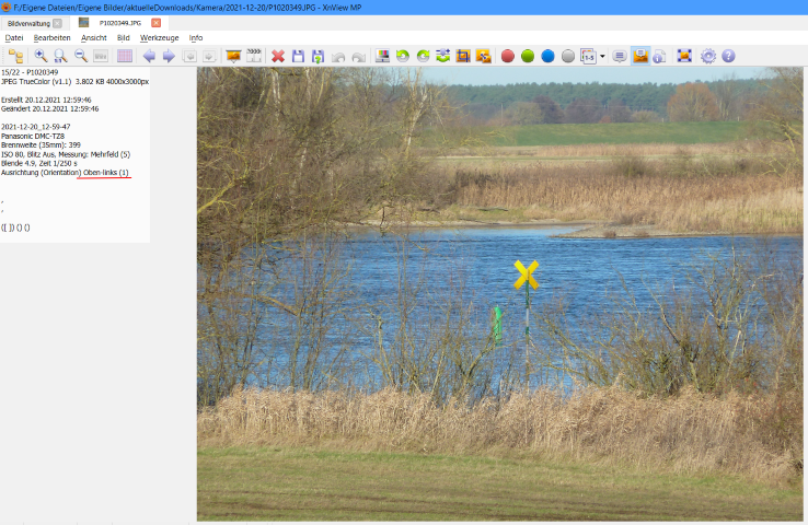

For this already mentioned issue I don't create a new bug report because it is closely related:
The information about orientation is wrong in image view:
Correct:
Wrong:

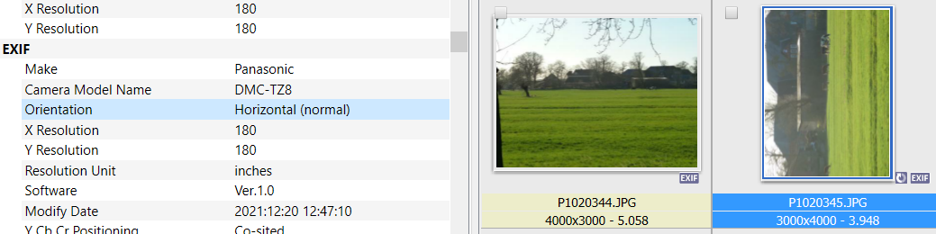

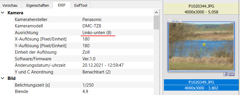

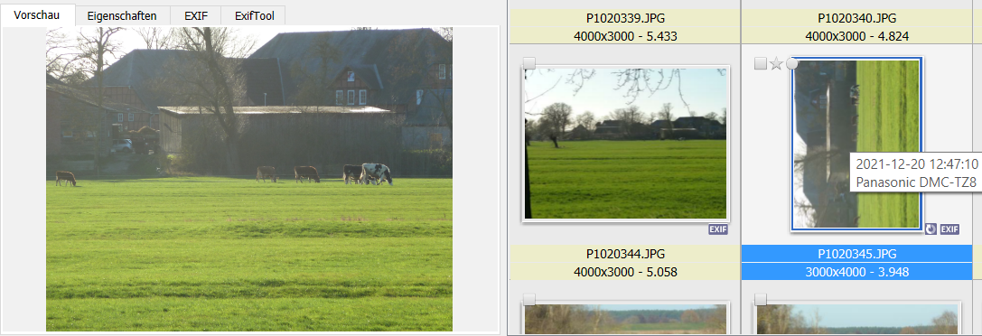

Unfortunately the issue is back after editing images.
These 3 files come from a camera that notes the orientation.
This file I have not edited:
These two files I have edited (only colors, not orientation!):
In image view the orientation is OK, in browser view it is wrong.
Here are the files:

@xnview
I am afraid that editing images might corrupt rotation. I did not change rotation that comes from the camera when editing the two files. Please, compare data in ExifTools of all three files. The one I did not edit has consistent data about orientation/rotation, the two edited files have inconsistent data.
