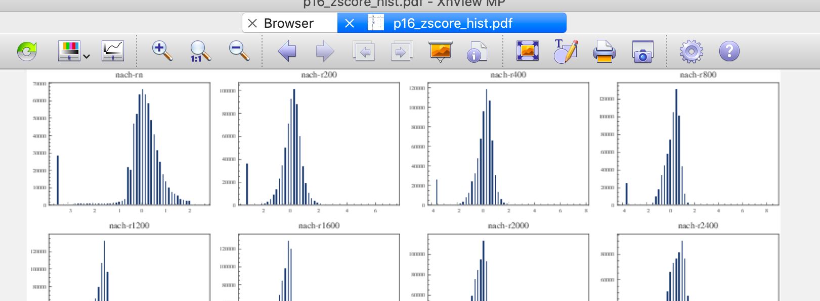

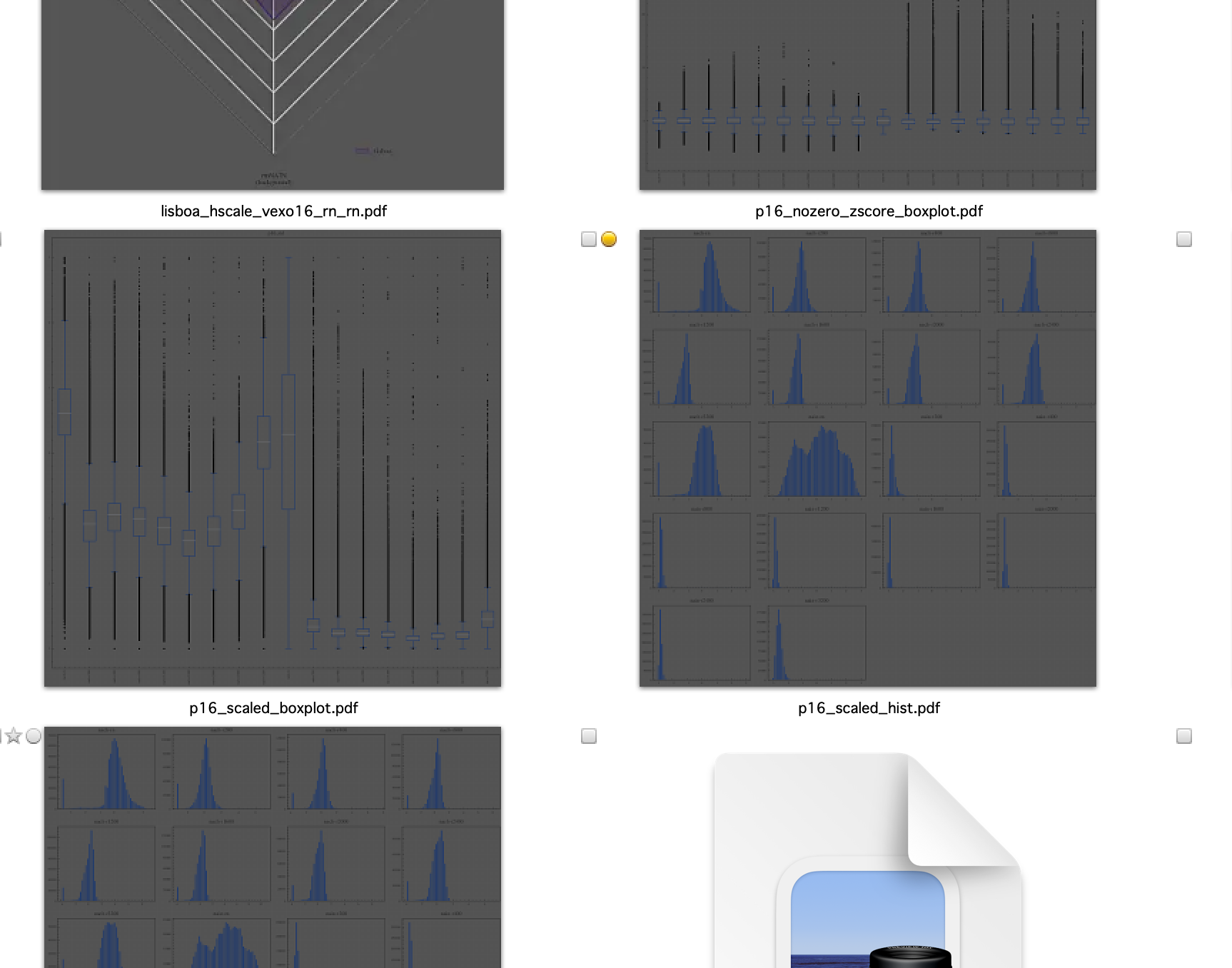

Recently, I've come across this bug that shows up with certain matplotlib (with tex backend) created pdfs.
Xnview correctly generates the thumbnails and opens the file. But the background is grey. It should be white (it's a white box background, no transparency). Other Mac apps open the file and generate it properly.
Could someone take a look and see what is going on with this file?
Thanks.
Joao

I also launched xnview from the terminal, hoping it would bring in the environment variables for gs correctly. It displays the same behaviour. It also prints a bunch of errors / warnings on the terminal console, related to libpng which I don't think are relevant:
All other image viewers and browsers are displaying the pdfs correctly (though I don't believe they use homebrew's gs). In addition, this only happens in xnview with some pdfs, like the one I sent, which is generated by latex through matplotlib.

Here's a screenshot of what I see:

Cannot reproduce the issue anymore, both in XNViewMP 0.99.7 and the new 1.0 beta 2. Homebrew tells me that the Ghostscript version remains the same. The only ghostscript dependency that got an update since I opened the issue was little-cms2, for color management. Either that, a minor MacOS update, or the digital spirits fixed the issue.
Please feel free to close this bug report.
