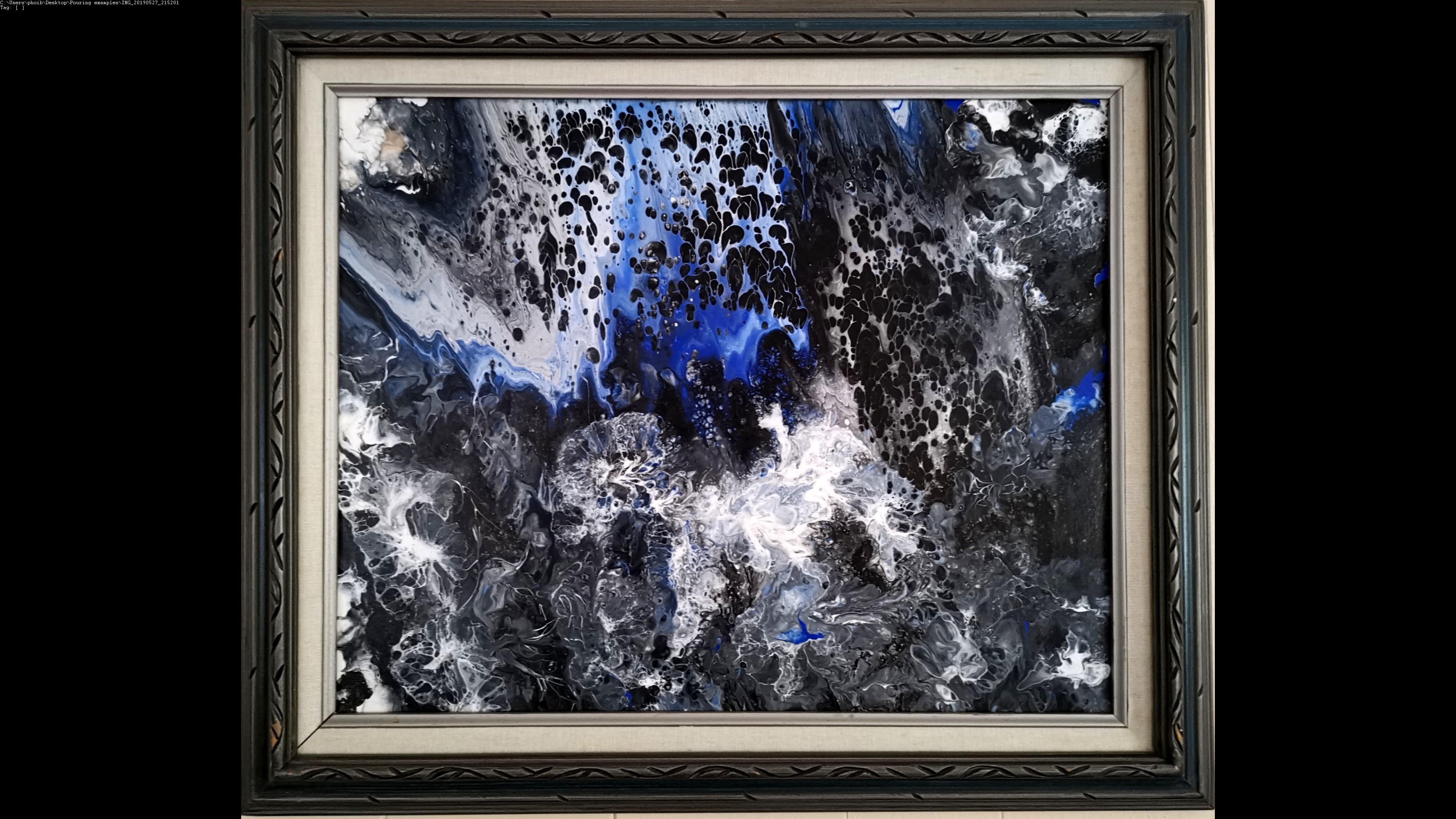

I use the fullscreen preview a lot. It works great, except the file info text is so small I cannot read it. I have attached a screen shot that shows a jpg with the text almost invisible at the upper left. I am using win 11, at 3840x2160.
I can not figure out how to increase the font size of the file info text in fullscreen only.

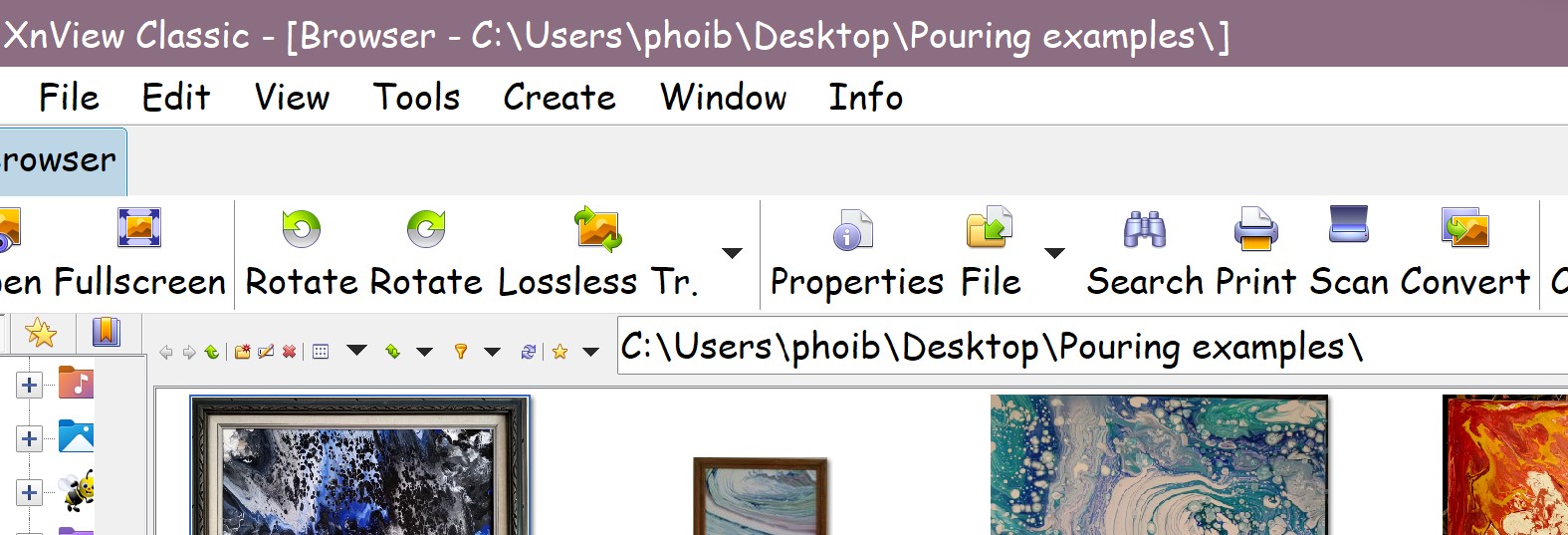

In a similar vein, in the non fullscreen window, the main toolbar and menu are easy to read. However, Underneath the main toolbar is another toolbar (to the left of the folder location). These toolbar icons are so tiny they are impossible to use. I have also attached a screenshot of this issue.
Any help would be appreciated.

Re: 250.4 font size in fullscreen preview
you can change it in Options>Fullscreen - Text settings
Thank you so much. I missed the tabs at the bottom of that page. I thought I had looked everywhere. For some strange reason it had defaulted to a size of 3.
At last I can see the text.
Thanks again.
