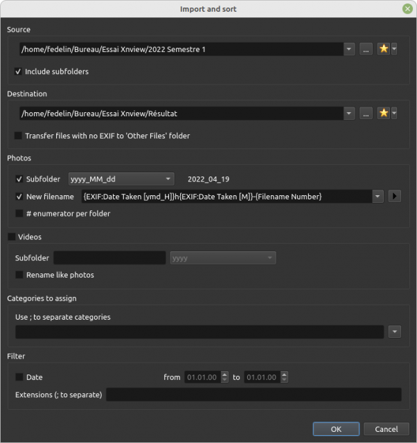

Tested under the following conditions
- Source folder has 180 files with a mix of raw, jpg and companion files (sometime more than one, ex: .arp (ART/RawTherapee) + xml). File names are consistent (i.e. graphic and non-graphic files do share the same exact filename, only final extension differ).
- Destination folder is empty
- Import and sort (see file attached) It works! Companion files follow the graphic file, even for those who have more than one companion file
But... during the process I am asked if I want to replace some already existing photo. It always happens (6 times) and always with the same photos. I removed them and I am no longer prompted. Problem: I haven't been able to understand in what would these photos be different than the others. Reason why I though it could be worth mentioning it... François

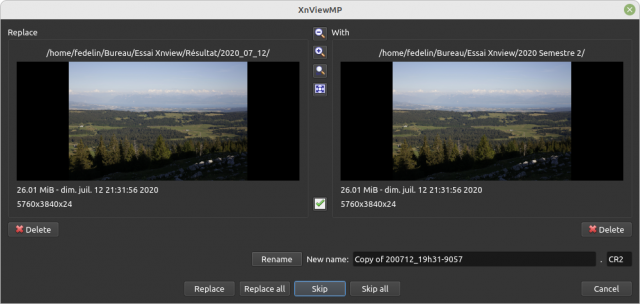

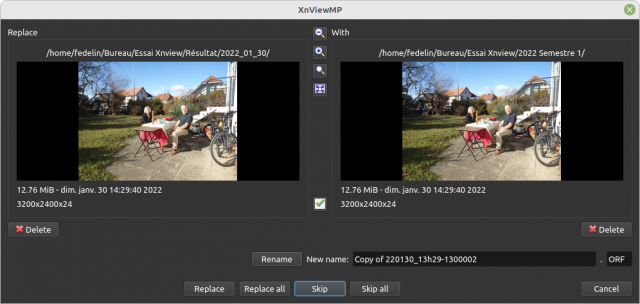

Strange, on source folder, you have not the same file?fedelin wrote: Tue Apr 19, 2022 6:56 pm But... during the process I am asked if I want to replace some already existing photo. It always happens (6 times) and always with the same photos. I removed them and I am no longer prompted. Problem: I haven't been able to understand in what would these photos be different than the others.

Troubleshooting with another folder "2020 semestre 2" as source (about 500 photos + sidecar files .arp, .pp3, .xmp, sometime more than one per raw).
Same scenario: transfert ok but several popup windows stating the target folder ("Resultat/AAA_MM_JJ") already contain the file, which is true (verified in // of the import).
Further investigations show that in some of these folders there are orphelin sidecar files (i.e. no more RAW with the same file name). Still I haven't been able to find evidence it is a cause. Will do further tests later in the week.

Tested on 5 files only, I have been able to narrow down the problem :
201024_17h58-0099.arp
201024_17h58-0099.CR2
201024_17h58-0101.CR2
201024_17h58-0101.CR2.arp
201024_17h58-0101.CR2.xml
RAW #0099 : not prompted for an already existing CR2 in the target folder but no transfert (neither of the two files)
RAW #0101 : prompted for an already existing CR2 in the target folder, click skip/replace (no difference) then the 3 files have correctly been transfered
It's like the import process:
- creates the timestamp subfolder,
- move the CR2,
- at the time .CR2.arp & .CR2.xml are moved, it tests a potential existing same file in the target folder without taking under consideration the second extension (i.e. .arp/.xml), finding the previously moved RAW thus prompt for a skip/replace/rename replacement but without effect because the sidecar files "on their way" do not have the exact name than the RAW (i.e. has an extra extension at the end).
Hope this help...
