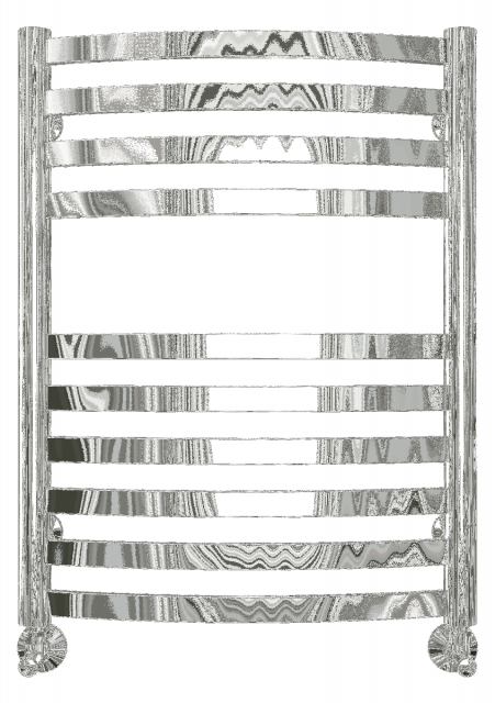

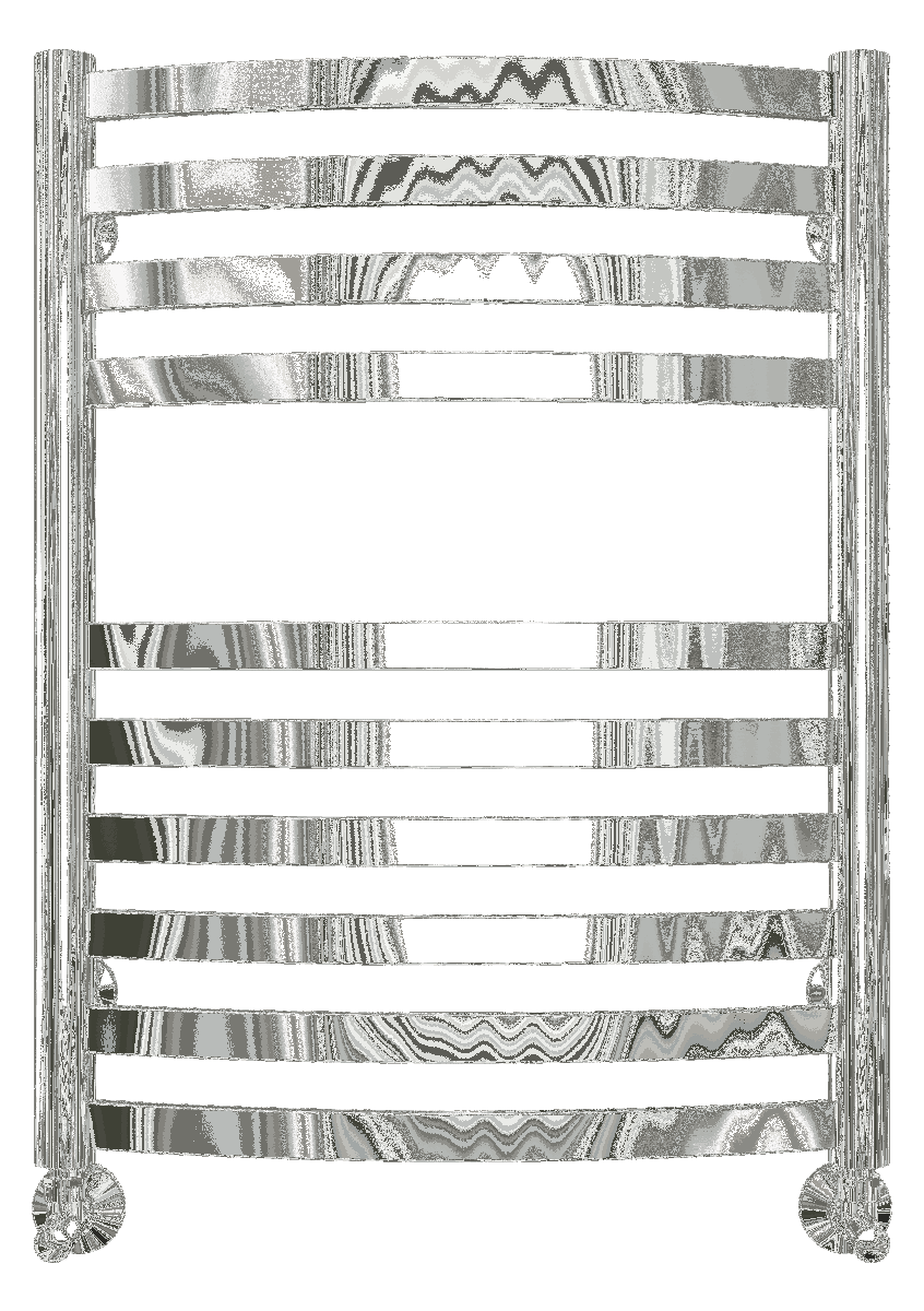

Hello. I want to crop the photo, but I get a poor quality photo. Please tell me how to fix the problem

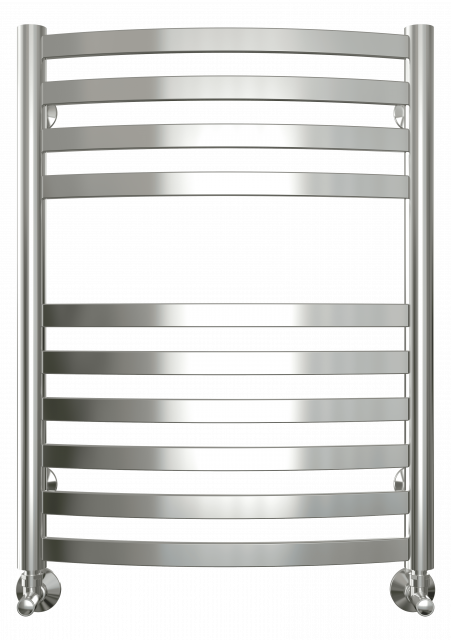

I don't quite get it : you are not cropping anything here.
Whatever, I'm no expert but I'd try to add
-out png -clevel 9
to specify the output file format (png) and the compression level.
 -overwrite -out png -clevel 9  -ratio -resize 1500 1200 -rflag decr
It's giving me an image with the correct colors.
If you have different images from different sources, I'd add also something to deal with transparency, alpha chanel, metadata and so on to make smaller files.
Posts: 4619
Re: Resize png 8 bits
The GUI software XnConvert, with it's Actions Preview, can provide an easy way to test different settings, but testing with 1.95 I haven't managed to obtain the desired result, no breakup of the image though.

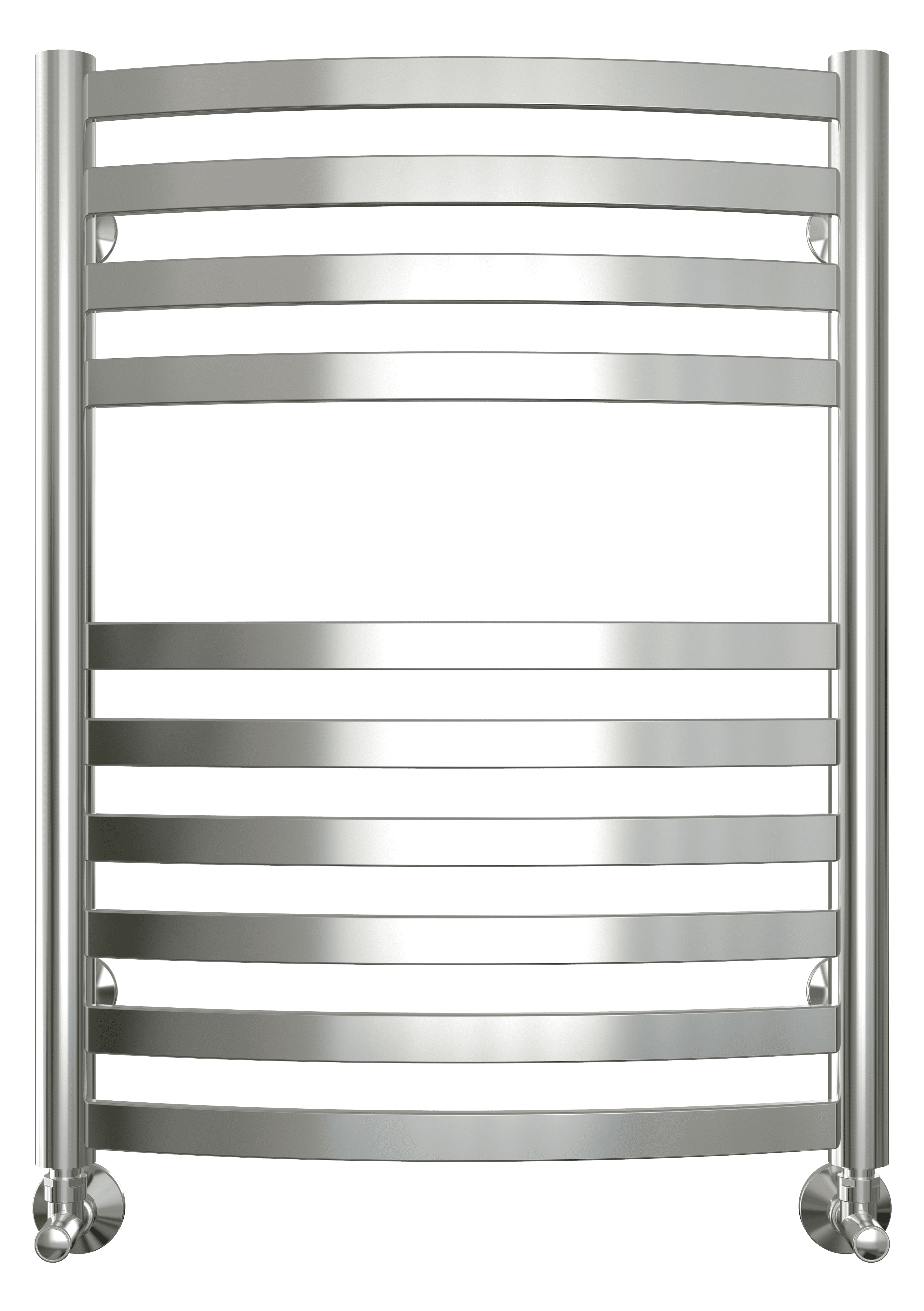

In my case, the problem was solved by adding a parameter -rtype quick
nconvert -overwrite -resize 1500 1200 -ratio -rflag decr -rtype quick image.png
