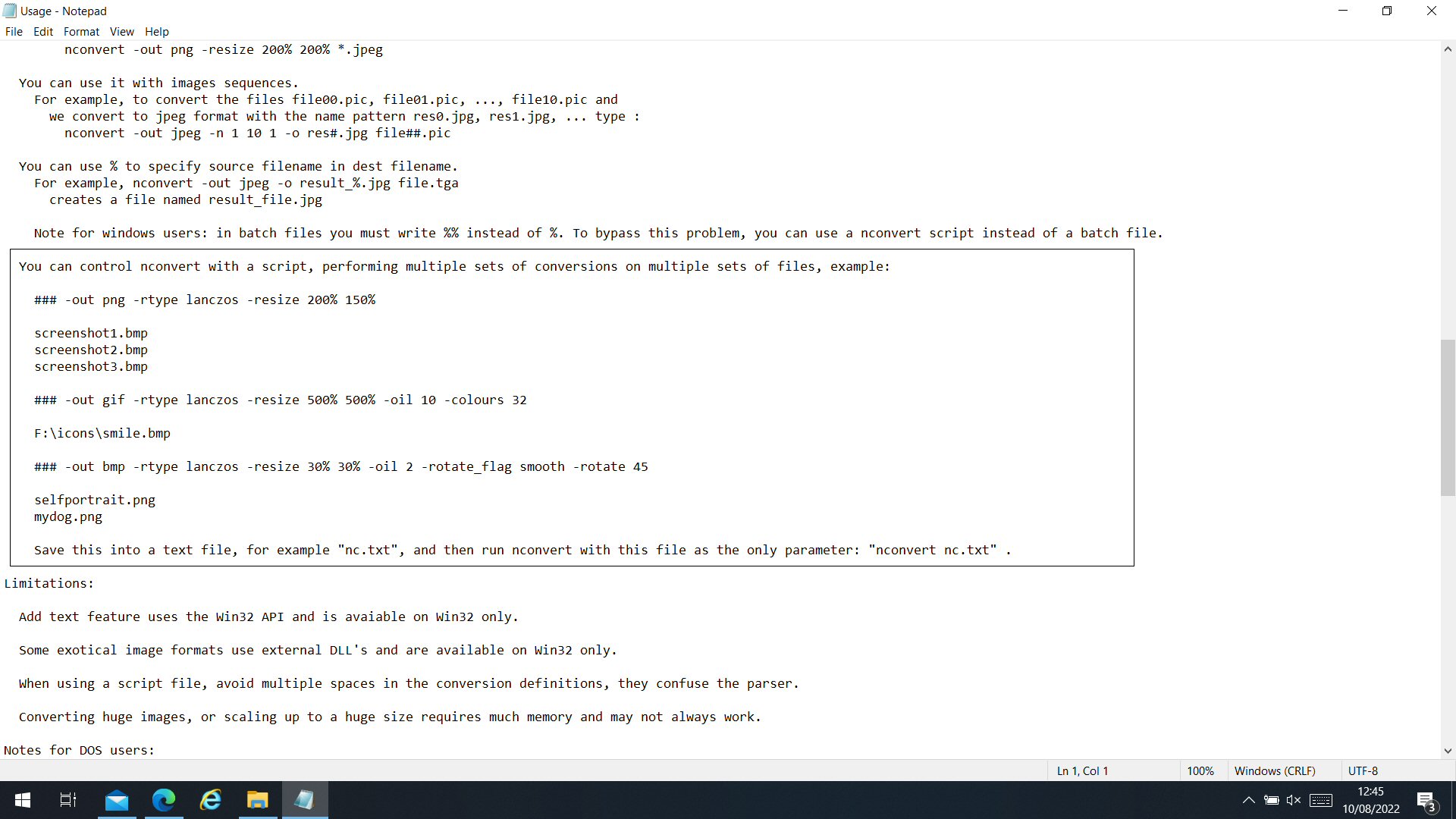

I've based it on examples from the readme files that came with Nconvert
Screenshot attached
I've used it to perform tasks on multiple files before now, but one command covering all the files (i.e. simply list all the files first, then the command) - works a treat
Screenshot attached

The file you are referring to is from the wiki and I have seen it before, but didn't understand the ### notation then and haven't seen it defined since.staylor43448 wrote: Wed Aug 10, 2022 11:48 am I've based it on examples from the readme files that came with Nconvert
My feeling remains that, irrespective of how you run the code, you will probably need to define a variable that you can then use in a loop, possibly a For ... In ... Do ... that acts on a folder containing your source files to be processed.
Helmut originally created the NConvert support guides, so although your problem is not directly related to that notation, or may not be related, with his much greater experience with scripting NConvert, possibly he can provide some support? That will likely not be until much later in the day, though.
