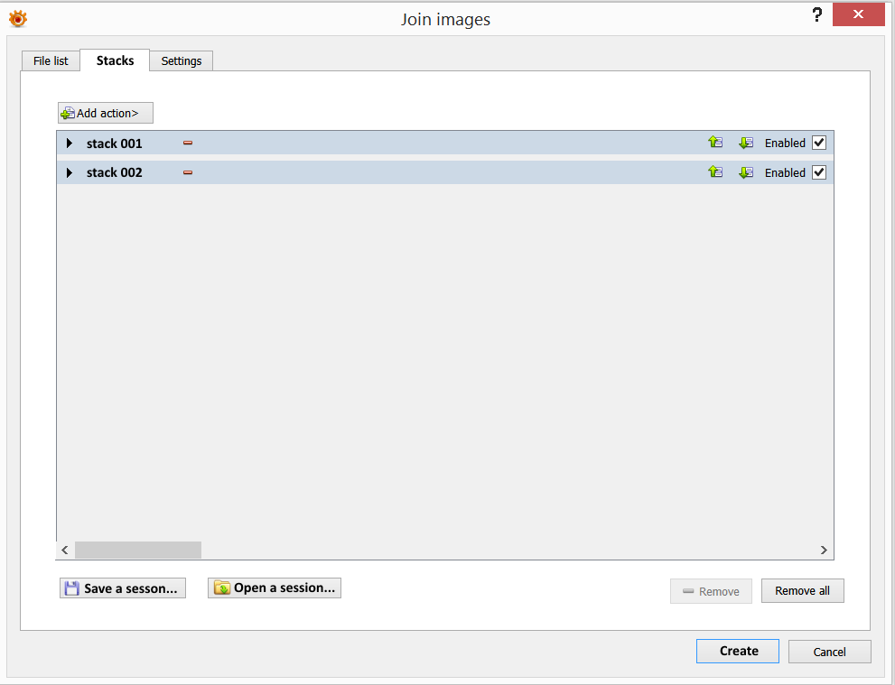

I had the idea of naming this feature as 'Stacks', see this topic here: viewtopic.php?f=60&t=43932&p=180691#p180691
Below I have just created this mock up image to illustrate how it could look like in the "join Images" window. Notice how I created another tab called 'Stacks' an I used some UI elements from XnConvert's 'Actions' feature...
When you expand each stack, it would give you a thumbnail preview of the image for which you can re-arrange the order just like in File list.
