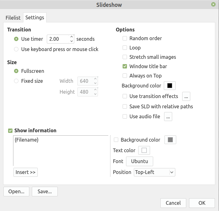

1 If you want to use the slideshow tool of xnviewmp
- Select pictures
- Create > Slideshow
- Settings , select {filename} with "Insert" button ...
- Adjust other settings ...

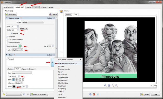

2b - If this software can't use any metadata, you can copy filenames in an new area below the displayed photo :
- Select pictures
- Tools > batch convert > Actions > Add action > Image > Canvas resize ...
Check "relative " and "keep ratio" , add for example 100 pixels height, position top left , choose background color , and see if preview is ok.
- Actions > Add action > Image > Text
With the right arrow menu of text field, select Filename without extension. Adjust font size, position, font color (!) , ... , see if preview is ok .
- Select the output folder in "Output" tab, and see also all other settings .
- "Convert"

I don't use the browser Slideshow function, that looks a good start, but is there any control over where the text is placed on the image?
Assuming there is, presumably if desired the filename could be placed below the image on new canvas previously added in a batch canvas resize.

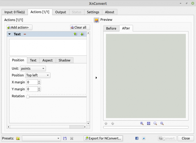

I don't see that option that I was looking for before, see the screenshot in my first post... A screenshot?

- In your 2nd screenshot for XnViewMP slideshow , is "Position : top left" the control you are looking for ?cday wrote: Mon Nov 21, 2022 11:41 am
- (...) use the browser Slideshow function, that looks a good start, but is there any control over where the text is placed on the image?
- I don't see that option that I was looking for before, see the screenshot in my first post... A screenshot?
- In your 1st screenshot, the horizontal scrolling seems buggy, you should see the arrow menu near the "Text" field ...

Rechecking, in both the current version of XnView MP 1.3.1 and the latest version of XnConvert 1.96, it is necessary to drag the relevant window unusually wide to see the full interface, never seen that before...michel038 wrote: Mon Nov 21, 2022 3:30 pm
