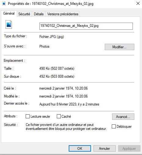

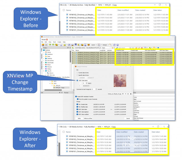

Just downloaded and installed: XnView MP Windows, Version 1.4.2 64bits (Jan 23 2023), Libformat version 7.136. Things are not working the same as they did the day prior to updating. If I modify dates using Tools>Change timestamp I no longer see the mdate or cdate in Windows 11 file Manager but they show in XNView. Dates show in Windows 11 File Manager prior to changing with XNView, but not after.

XnView shows correct changed date, but not windows explorer??

May be easier to understand by looking at the attached file. The resulting File:FileModifyDate and File:FileCreateDate do not appear to be what they should be. This worked fine prior to my update to this latest version of XNView.
The pdf shows all EXIFtool metadata for one of the files after the attempted change with XNView.
