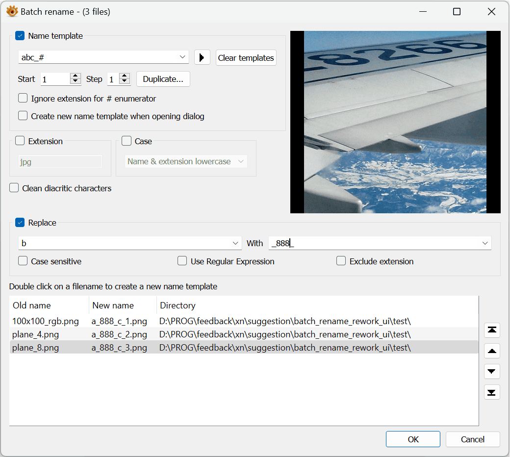

Batch rename - rework UI
Bugs which are supposed to be fixed in the next test version (not available yet)
Posts: 2996
XnViewMP 1.4.5 64bit
Batch rename
dialog looks a little bit clumsy
make few UI adjustments
  • General
    - add functionality to add/delete files
    - rework Name_template saving functionality into global Preset (similar to Batch convert dialog)
    - rename OK/Cancel buttons to Rename/Close
    - actually Directory column is not that essential in this dialog (see Advanced Renamer UI below), but I left it in place for now.
  • A
    - rearrange dialog layout to display more files on the screen
    - remove 'Create new name template when opening dialog' as it does not required anymore
  • B
    At that point it feels like, why not to use Batch convert instead - just add rename actions and new Filelist tab after Before/After in Preview.
    Not sure, pro - all-in-one, cons - tool became more complicated.
    - remove image preview as there are not that much space left
    -- maybe show it as on_hover popup if required OR
    -- add thumbnails to the filelist
    - rework UI into Actions (same as in Batch convert)

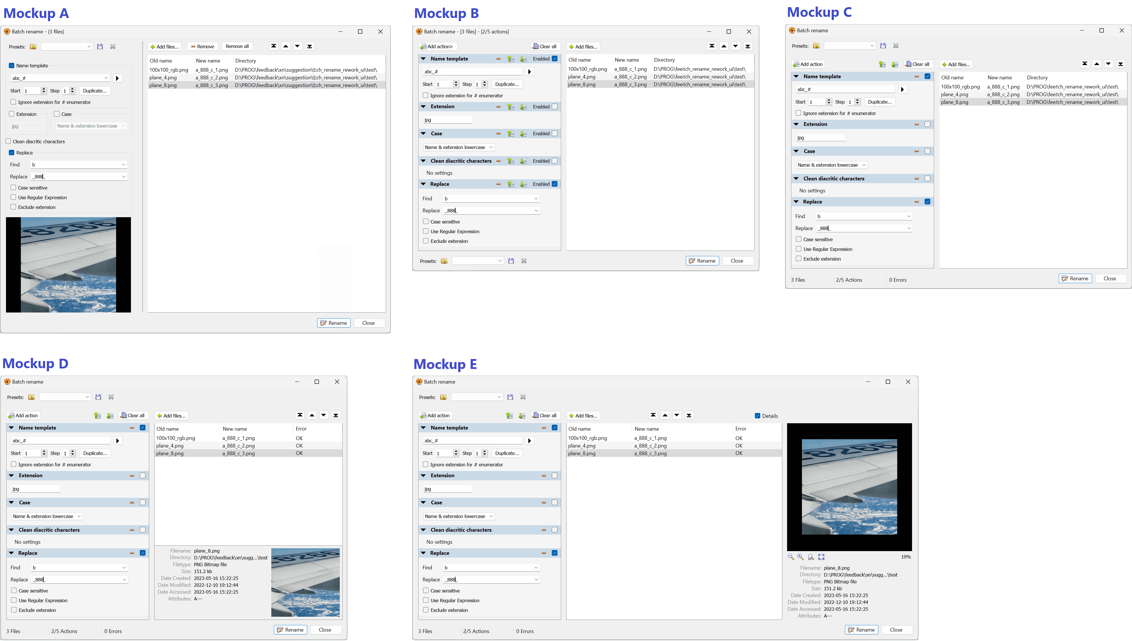

  • C
    - move Preset from bottom to the top
    - use bottom space as status bar
    - move Action up/down buttons to the top AND remove Enabled label for cleaner UI
  • D
    - add Details collapsible pane (under filelist area) that appears on file selection
    - add Error (or Status) column that indicates if there are any issues with renaming sequence (or file access)
  • E
    - add Details pane on the right. Invokes via checkbox, can be sized as in Draw

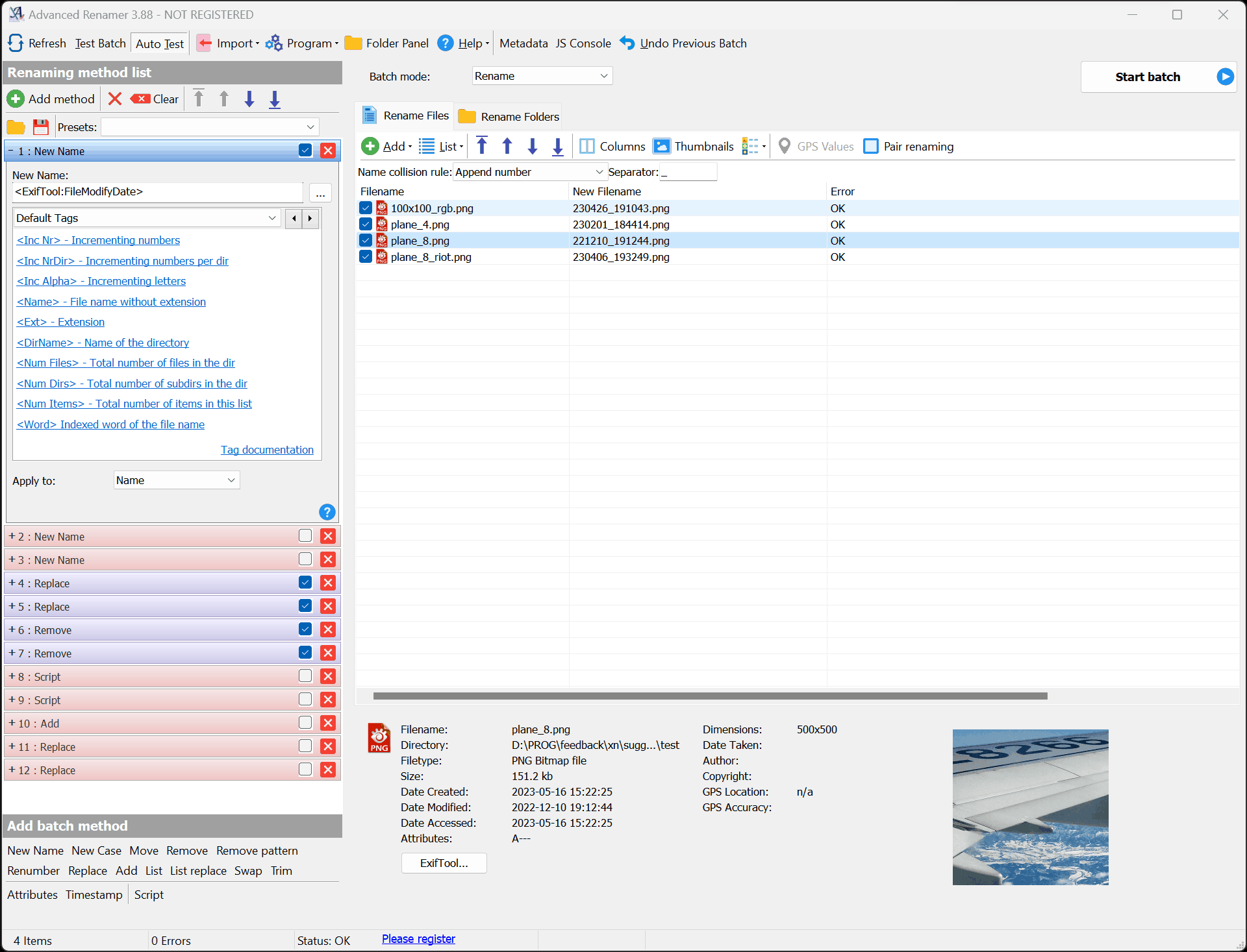

  • Advanced Renamer
    the best renamer I know so far

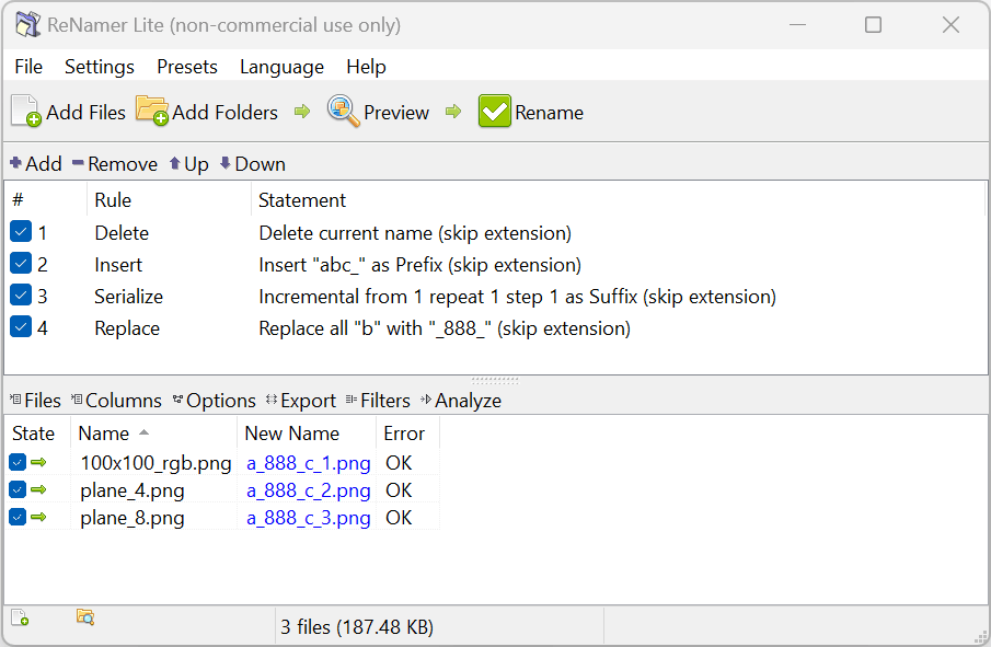

  • ReNamer

Re: Batch rename - rework UI
Mockup A is better but in this case we can't resize dialog to grow preview
but who need to resize preview in rename tool..
it is also possible to zoom_by_mouse_scroll and drag it by RMB.
As for me, I never wished anything bigger than small preview in Advanced renamer.
ps: the main benefit of 'Action structure' - clear understanding of actions sequence and ability to duplicate/reposition them
UPD
added mockup D (my favourite so far)
Mockup E - it can be positioned on the right and be:
- collapsible, like regualar Preview
- resizable, like details panel in Draw
Posts: 47882
yes Mockup E is good, without Actions. Only collapse/expand the option...
Posts: 2996
sounds good 👍

Posts: 47882
i've tried Mockup E, but i think that dialog is too big.
Should the preview be resized?
Thoughts from other users?
Post by cicciobello »
xnview wrote: Thu Sep 28, 2023 6:52 am i've tried Mockup E, but i think that dialog is too big.
In this dialogue the preview has only the control function, and is secondary. So the small preview is fine.
The most important thing is the filename column (old name -> new name). Sometimes I have long file names, and I would like to read them completely.
Having the column with the directory name is also very useful to me.
In my opinion, the D mockup (with preview below) can be enlarged to better read the file names and adding the directory.
Posts: 47882
yes mockup D is better to resize, something like that
You can resize the file list/preview
cicciobello
Posts: 239
Approved!
Posts: 47882
Thoughts from other users??
cicciobello wrote: Fri Sep 29, 2023 5:01 pm Approved!

Posts: 2996
actions pane can be narrower ~30%, eg:
- replace "Clear template" button with "X"
- rephrase "Create new name template when opening dialog" to "Create new template on open", but I would rework this as it feels too complicate
eg mockup E is 1770px wide, can be squeezed to 1630px
xnview wrote: Thu Sep 28, 2023 6:52 am Should the preview be resized?
yes, the same way as details pane in Draw
but there shall be some minimum size limit
xnview wrote: Fri Sep 29, 2023 2:00 pm yes mockup D is better to resize, something like that Clipboard-1.png
well..
  • if there is no ability to change actions' order, I doubt its required to place them one under another, eg "Extension" and "Case" can be left untouched
  • "Clean diacritic characters" also can be left as is, I doubt it deserves its own group without details
  • its better to align beginning of Replace fields
xnview wrote: Fri Sep 29, 2023 2:00 pm You can resize the file list/preview
Resizing is fine, but I'm afraid there will be a lot of unused space in preview area when its minimized in favor of filelist.
Judging from personal experience in other apps, I usually add ~50-500 files to rename, and quick scrolling to see if there are any errors is much easiest with tall filelist area.
