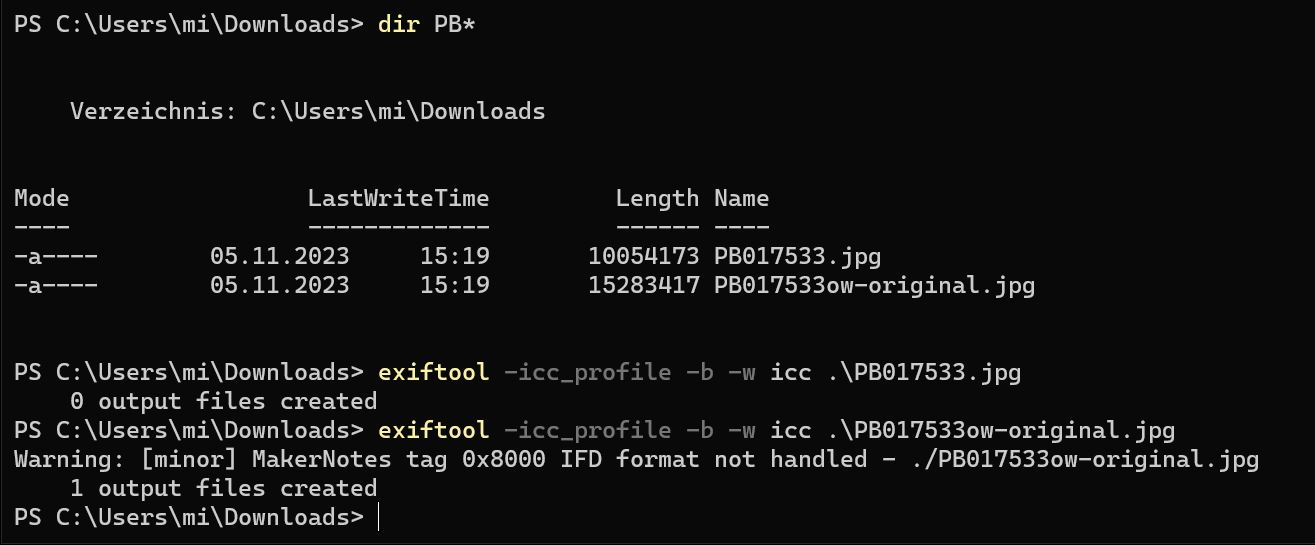

Re: different colors ooc and generated jpg from raw

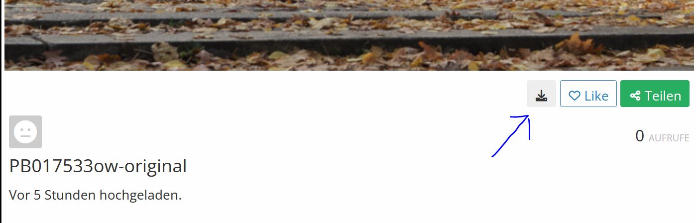

Did you download the files using the download button?
I just downloaded those into my Download folder and used exiftool to look if they have icc profile embedded. As said: The ooc image does not, but the OM WS generated jpg from raw does:

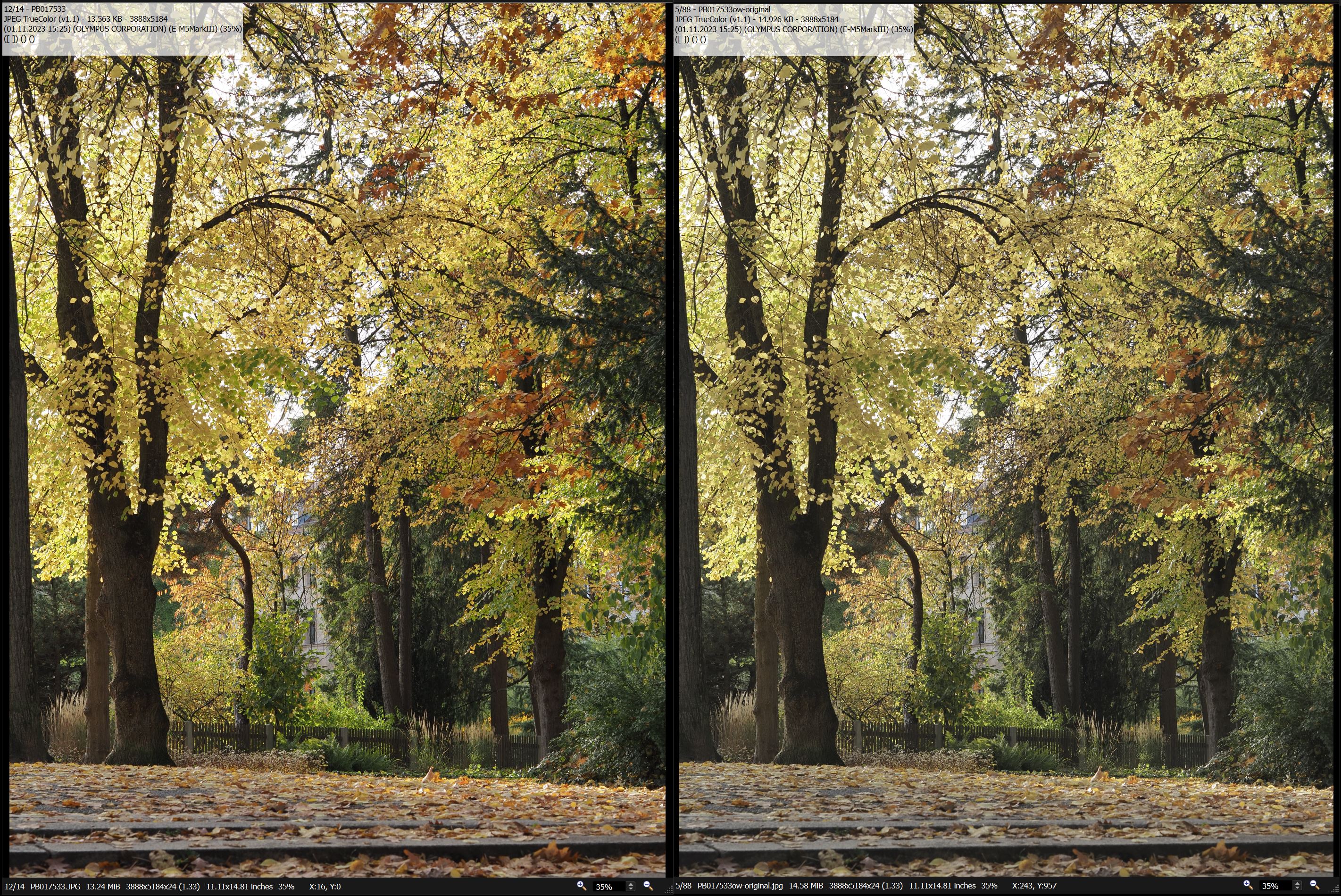

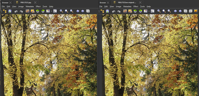

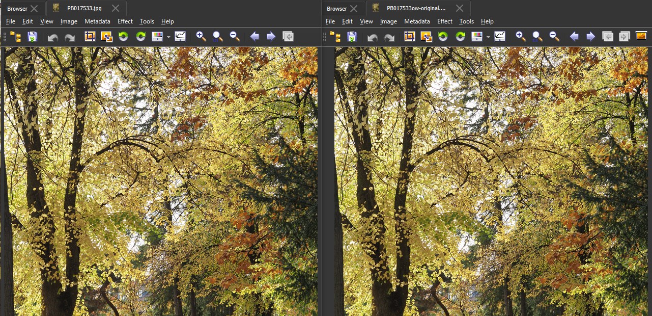

that is wired. Here as requested.
First my setting: I opened two sessions to put the pictures side by side. This is the screenshot using the snipping tool: update:
I just notice, that the image provider alters the files
Screenshot4 is taken with the originals from my hard drive, not the downloaded ones.
Please use the originals provided here. You should get the same result as in screenshot4:
https://file.io/WrqKrs92XR0G
I also included the ORF file (which is probably not needed) (all files will be deleted after 2 weeks)
- Posts: 49071
i have not that, all 2 files are the same in first in your screenshot... Is it 1.6.1?

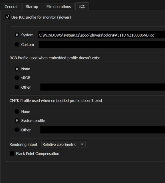

I set "RGB profile used whem embedded profile doesn't exist" to "sRGB" and everything looks the same now.
This should be default IMHO.
My Olympus and Canon cameras (5 cameras) out of camera jpg images are all without embedded profile, which means per default they are all falsely rendered. (This happens if you have a fully calibrated monitor/display which can represent a huge amount of color range, where an icc profile is generated as used system wide.)
