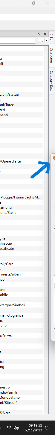

I checked again and realized that the window for changing the batch rename options is actually opened but in an anomalous position: it is on the right side outside the view of the monitor (see attachment).
After moving the window into the correct position, I closed it. Then I opened it again and it appeared in the same anomalous position as before.
