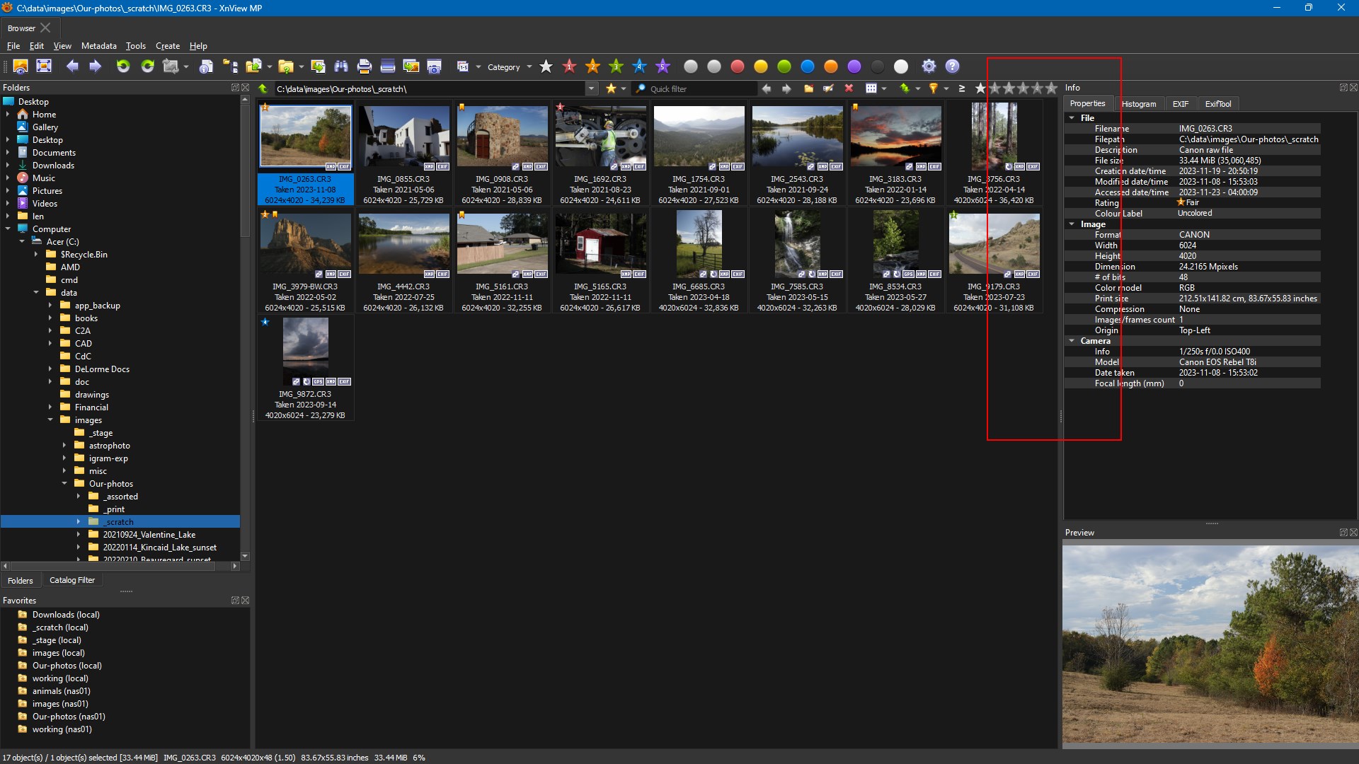

I have two displays, both 1920x1080. Here's the sequence...
1. Launch XnView and it's correct (I adjusted last session, several hours ago):
2. Move it to my other display (both displays are 1920x1080) and it changes:
3. Move it back and it stays changed. Close and relaunch and it stays changed, doesn't return to how it was last session. Note the width of both left and right panes has changed.
So this time it changed when I dragged it from one display to the other, maybe when it "normalized" (not maximized) during the dragging process. But I've seen the same kind of change simply from one session to another, usually at least overnight between.
Thanks.
