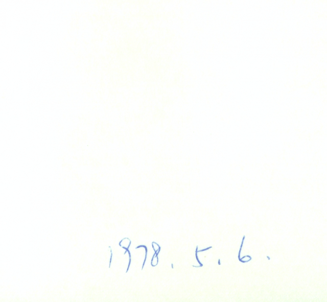

I'm scanning some really old photos and I'm wondering what is the best practise for archiving this
so firstly I'm scanning without any colour correction because the scanner really stuff it up
I have two resulting scans:
front pile, the actual photos which are generally yellow with age and slightly faded. I don't have time to fix them individually I wonder if it's work doing any type of patch fix or to just leave it aas scanned?
back pile, some of the photos have things written on the back. Originally it would be blue ballpoint pen on white paper come on now it is slightly faded blue ballpoint pen on white and yellow paper. I feel like I should be able to clean these up in batch somehow. For example removing all the yellow should be simple. after that is there a way to enhance the actual text? If I use the contrast slider it actually makes the text become thinner so it doesn't help.
What actions would you suggest for this? I've only really used the actions for resizing in the past

Maybe you could post some example images?
obelisk
- Posts: 491
- Joined: Fri Jan 09, 2009 9:54 am
Re: Cleaning up old photo scans
the front varies a lot some are under exposed some are yellow and some are purple

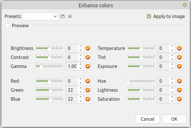

I learned early in my scanning days that editing colours was whenever possible best avoided, fortunately the material I was typically scanning could usually first be converted to grayscale and then enhanced much more easily using a levels adjustment!
I have, however, taken a quick look at your example 'back' image, and used the Image > Adjust > Enhance colors... to obtain at least a slight improvement using these quick settings:
Resulting in this possibly slightly improved image:
Possibility of some further improvement with refinement of the settings used, a second similar adjustment applied to a selection in the lower-right part of the images seemed to help although with a slight loss of density in the blue text. As the immediate aim in this case is to be able to read the date that might be acceptable?

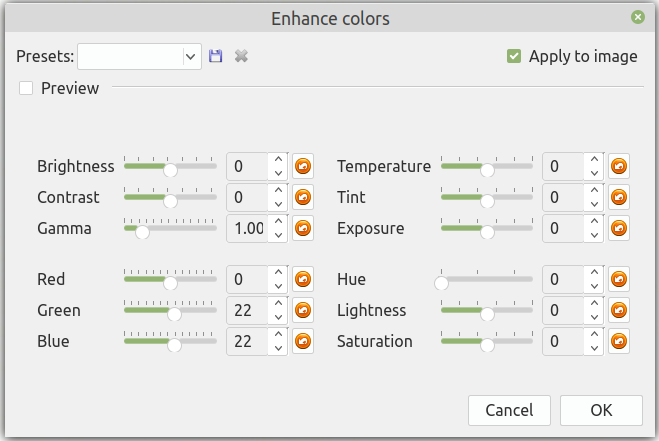

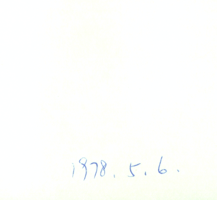

I suspect that an alternative solution might use a reduced colour palette, XnTriq?

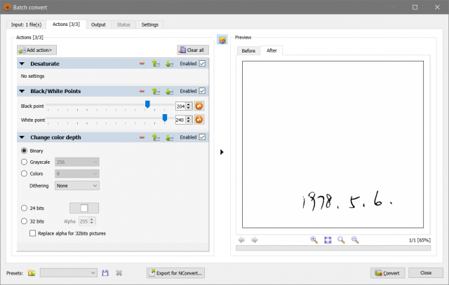

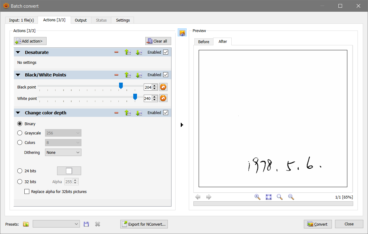

cday wrote: Fri Mar 15, 2024 9:08 amI suspect that an alternative solution might use a reduced colour palette, XnTriq?
nconvert -desaturate -levels 204 240 -binary nodither -out png -clevel 9 "X:/D4DIP0V.png"You do not have the required permissions to view the files attached to this post.
