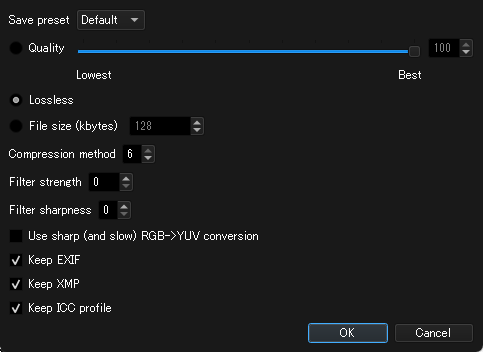

[001.png]
-Basic Settings-

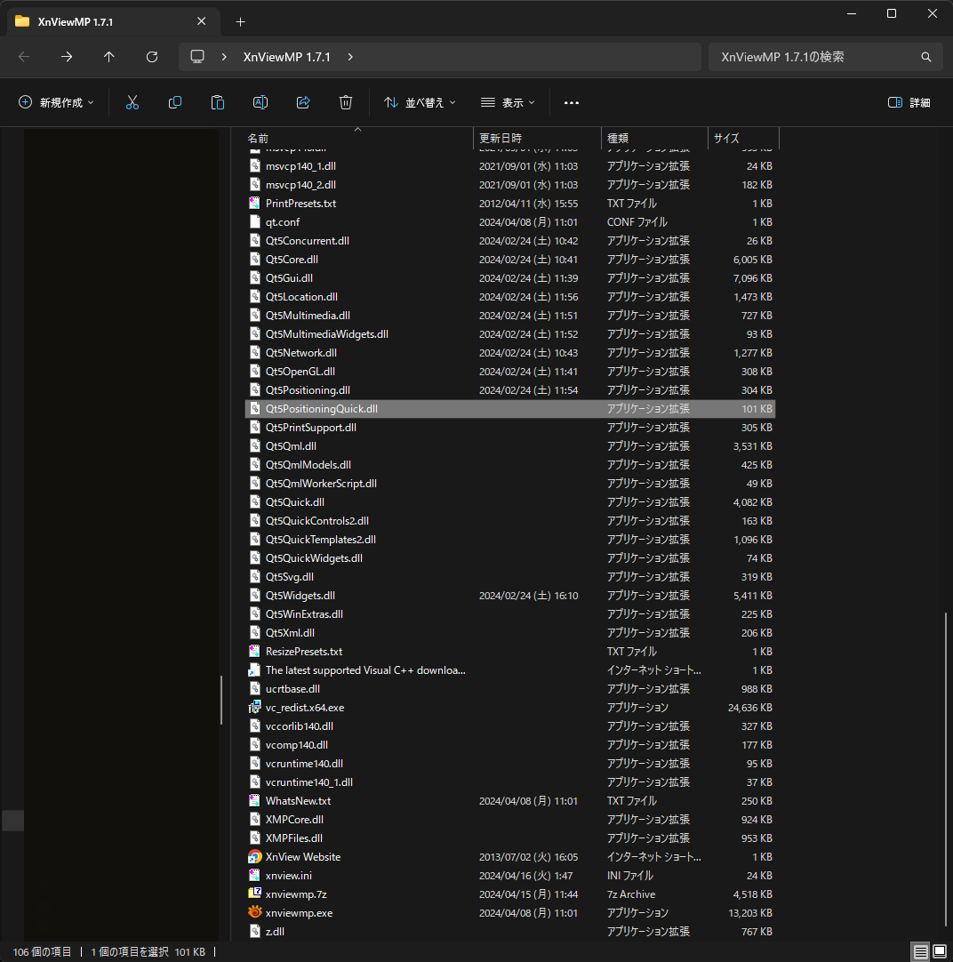

3.
・Overwrite each dll in the same hierarchy as xnviewmp.exe in XnViewMP1.7.1 with the dll in XnViewMP1.5.5, and check the operation.
Check if the sample can be converted to a webp image using Compression method 6.
・If the application fails to launch as a result of overwriting the dll, it will not be possible to verify its operation, so consider it as a candidate for suspicious files.
・dll files newly added from XnviewMP1.5.5 to XnViewMP1.7.1 will also be considered as suspicious file candidates.
*Results*
・DLL that no longer launches after overwriting with older versions
[Qt5Widgets.dll, Qt5Gui.dll, Qt5Gui.dll, Qt5Core.dll]
・DLL that produces an error message and doesn't launch after overwriting with older versions
[Qt5Network.dll, mdk.dll]
・Newly added DLLs
[libssl-3-x64.dll, libcrypto-3-x64.dll [*Note 1]]
・The above eight dlls cannot be swapped with the dlls of the same name in XnviewMP1.5.5. In other words,
it is not possible to verify the operation of each individual file.
For convenience, let's call these eight DLL files [β].
・However, as of Experiment 1, since [A] was operating normally during the sample image conversion, the suspicion on [β] is weak.
・If you can even launch [a] combined with [β], you will be able to narrow down the suspicion to only xnviewmp.exe of XnViewMP1.7.1.
This is because there were no abnormalities in [β] during the experiment with [A].
(*Note 1: Tried to replace libcrypto-1_1-x64.dll and libssl-1_1-x64.dll included in XnViewMP1.5.5, but it did not launch.)

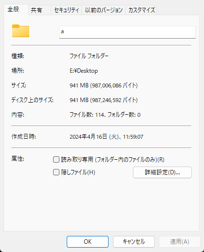

Original
941 megabytes, 987,006,086 bytes)

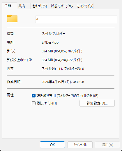

XnViewMP1.5.5 Compression method 6
824 megabytes, 864,052,787 bytes, compression time 3 minutes

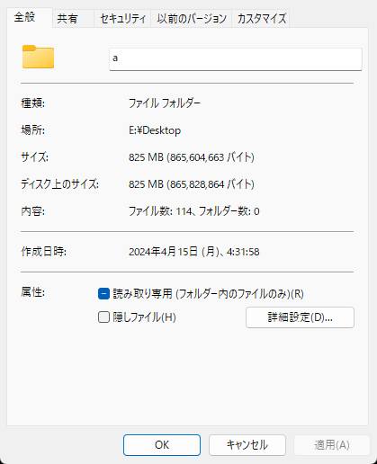

XnViewMP1.5.5 Conpression method 5
825 megabytes, 865,604,663 bytes, compression time 1 minute

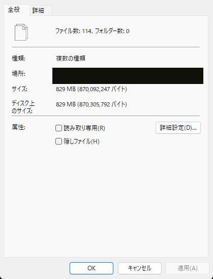

Experiment 1. [A] Compression method 6 (XnViewMP1.5.5's xnviewmp.exe embedded in XnviewMP1.7.1)
824 megabytes, 864,250,281 bytes, compression time 2 minutes [One more sample image of 30 bytes was mistakenly included]
・This is a combination of XnViewMP1.5.5 with the latest plugin, but there was almost no difference compared to [XnViewMP1.5.5 Compression method 6].
・However, I feel that the compression time has been slightly shortened.
・This [A] performance is a simulation of the latest version of XnViewMP without any bugs.
