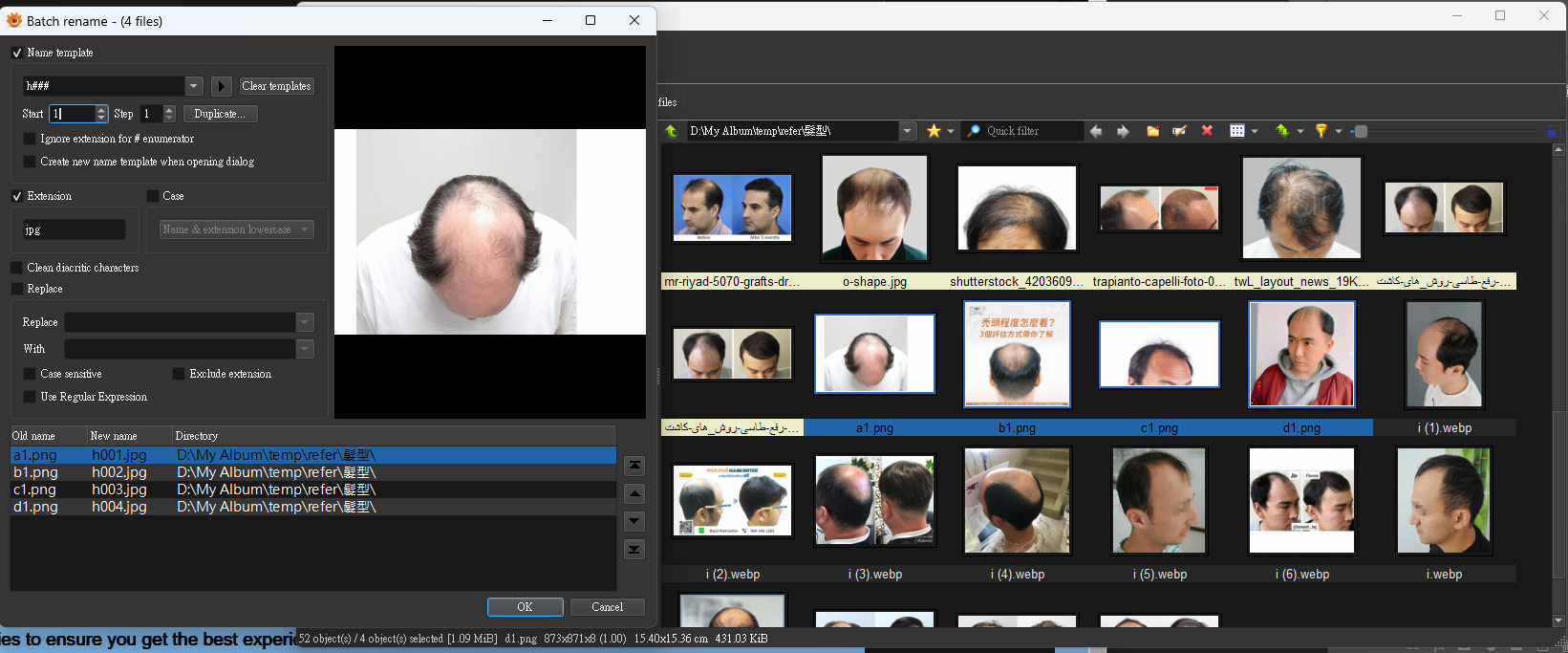

I found that after renaming the png format pictures in batches, they would be incorrectly displayed as jpg format pictures, but the format colors would be different.
The strange thing is that the pictures that are incorrectly displayed as jpg format are all in jpg format in File Explorer, but their size is png size, which is obviously a bug?
P.S. ver1.6.5 64 bit Windows

As you can see in the picture, after renaming several png images in batches, the extension name should be the default original image format(i.e. png), but it will always be set to jpg format (even though it can be changed).xnview wrote: Fri Mar 01, 2024 10:26 am you means that after renaming a png into .jpg, the display is not the same?
If the output is in jpg format by default, but the renamed file is still in png format color (not jpg color), the size is the same as the original image.
I just want to change the original image file name in batches, why does it change to a format change?

In your screenshot, Extension is ticked, with jpg ....
XnViewMP will therefore replace any extension (png ...) with jpg in the photo name, but the file format will not be changed.
You can use this option with "png" parameter to repair badly renamed photos.
And uncheck this option for future use.

In your first screenshot , before renaming, c1 and d1 were png photos.
In the 2nd screenshot, I can see c1.png and d1.png are pink (png color) . Right
And hh0001.jpg and hh0002.jpg are pink : that means their name is wrong, these files are png files. That's the problem.
If you only want to rename photos without changing format or extension, use batch rename without the extension "jpg" option ...
But now the wrong names ,( because jpg extension was used) are : hh0001.jpg and hh0002.jpg
You must do the reverse renaming : rename with "png" extension to repair ...
To convert png files into jpg, use "batch convert", they will get yellow color corresponding to jpg format.
