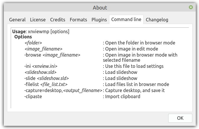

XnView MP Help > About > Command line tab options:
Edit: The ini file can't normally be renamed otherwise the program won't find it, but two copies could probably be placed in different folders and the appropriate path set in each instance's Integration > Paths settings. However, when the program is started in this way possibly an ini file with the name entered is created...

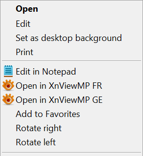

another option - use context menu
- win11 old context menu
(available via "Show more options" or Shift+RMB)
- via editing registry
Windows Registry Editor Version 5.00 [HKEY_CLASSES_ROOT\*\shell\Open in XnViewMP FR] "Icon"="\"D:\\PROG\\portable\\graphic\\XnViewMP\\xnviewmp.exe\"" [HKEY_CLASSES_ROOT\*\shell\Open in XnViewMP FR\command] @="\"D:\\PROG\\portable\\graphic\\XnViewMP\\xnviewmp.exe\" -ini \"D:\\test folder\\xn_fr.ini\" \"%1\"" [HKEY_CLASSES_ROOT\*\shell\Open in XnViewMP GE] "Icon"="\"D:\\PROG\\portable\\graphic\\XnViewMP\\xnviewmp.exe\"" [HKEY_CLASSES_ROOT\*\shell\Open in XnViewMP GE\command] @="\"D:\\PROG\\portable\\graphic\\XnViewMP\\xnviewmp.exe\" -ini \"D:\\test folder\\xn_ge.ini\" \"%1\""
